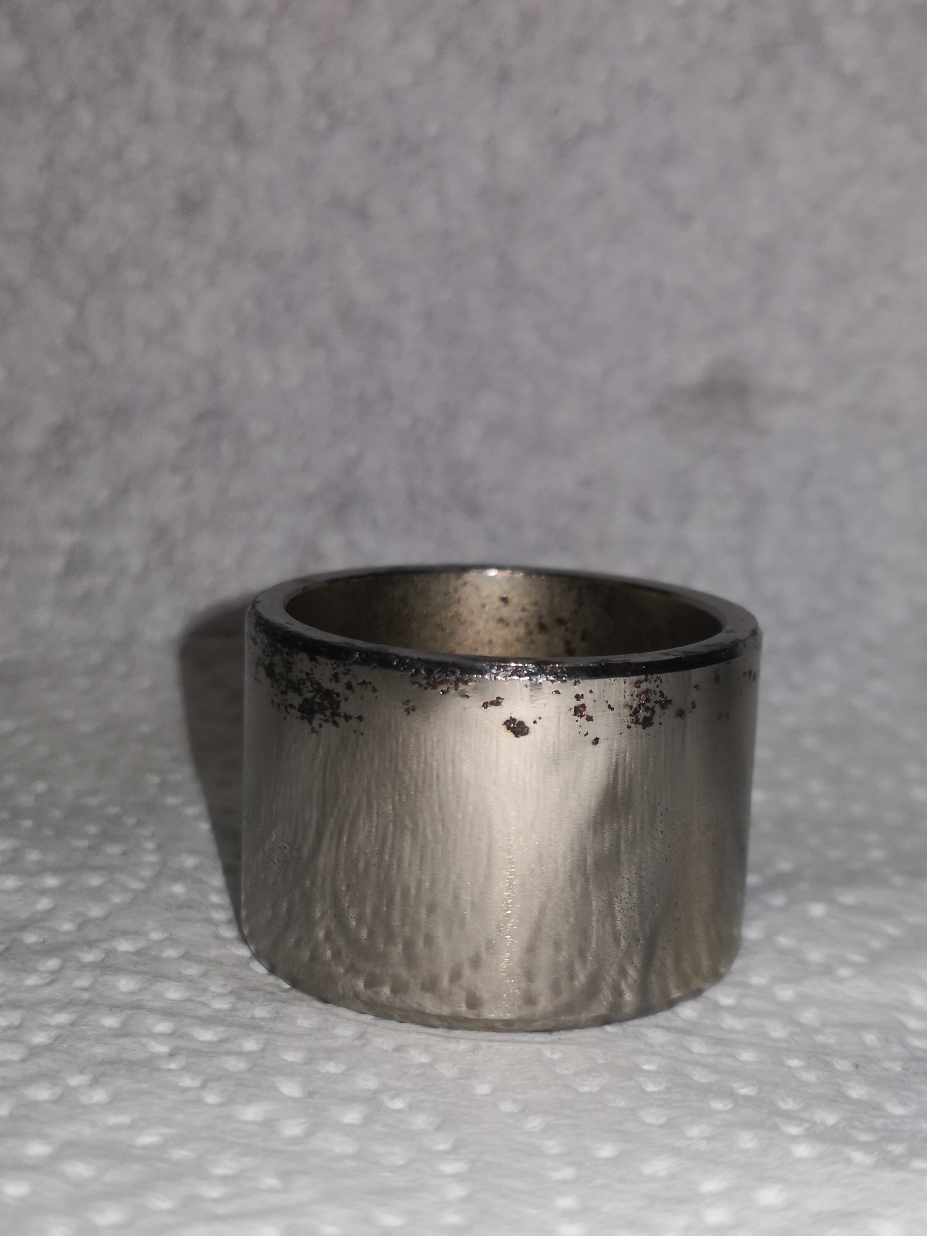

    Hi all, am undertaking front caliper rebuild on my 2002 Triple 955i.
    All good so far, but the top of the pistons (the pad end) is a little pitted and will not polish out. I am sure it is pitting not caked on crud.
    As this pitting is 'above' the hydraulic seal (ie the outside side of it) are new pistons necessary? The rest of the pistons (90%) are mirror finish.
    Or, as it's brakes....it'll be £150 well spent...?

    If you mean the ‘rim of the bucket’ it is inconsequential provided it bears pretty flat on the back of the pad. They should get a smear of brake grease on re-fitting to forestall further corrosion. Brasso is pretty good for polishing the important bits! Just clean it off well as it is a fine abrasive.

    Yes I would fit stainless pistons. I did think they had stainless. I have in the past sanded rough bits out and uses super glue then sanded back again.

    Look like this...

    They are goners stick them in the metal skip and treat your self to some stainless.

    As Joe said, bin them. Pointless skimping if your going to the effort of a caliper rebuild.

    I am curious to know how you achieved the Damascus effect......
    I would agree they are now past it.

    Polish up the piston's on a cloth polishing wheel ! Those pit's will still be there but very minor ! It's the rust that's sticking proud that will cause the most issues. I did the piston's on my America and the brakes are fine ! That pitting is right on the edge of where they start working. The sealing ring is several mm's back ! So all should be fine with new pads and rubber greased as mentioned above ... ! ... ?

    As you have overhauled the rest of the braking system and for the small nominal cost of replacement pistons replace them, it will give you peace of mind, plus 1 on the red grease.

    Thank you all....new pistons are on their way. I agree...I am sure it'll be all ok, but I may as well, seeing as I'm elbow deep and hundreds of pounds in (valve adjustments, steering bearings etc) I may as well replace the pistons then loose no sleep over it....
    Just to confirm....where am I putting the red grease?
    In the seal grooves?
    On the seals themselves?
    Does that include the little seals between the caliper halves?
    Lightly on the pistons themselves?
    On the bleed screw thread or is that copper grease?
    What about on the bolts that hold the caliper halves together, copper grease?
