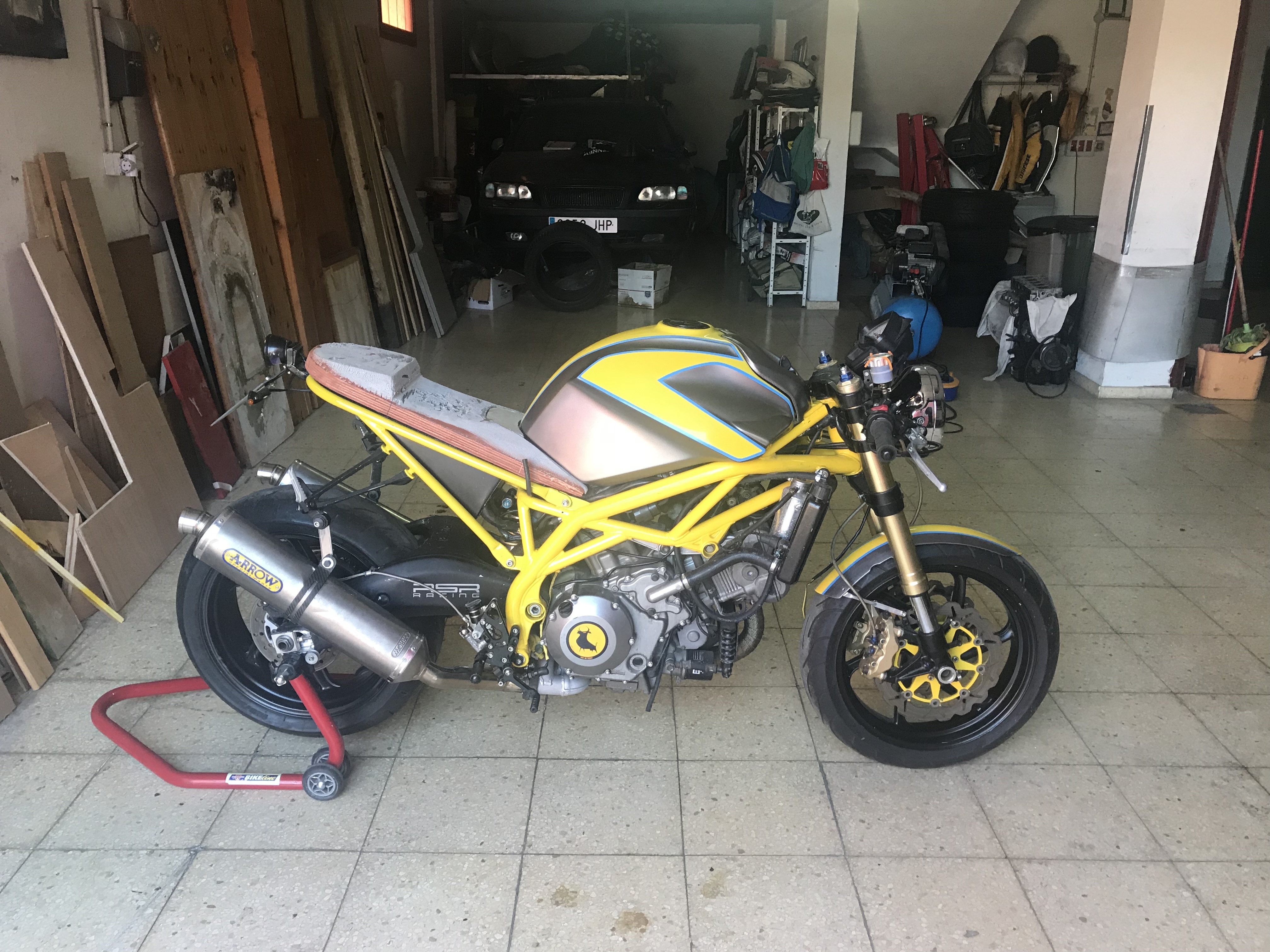

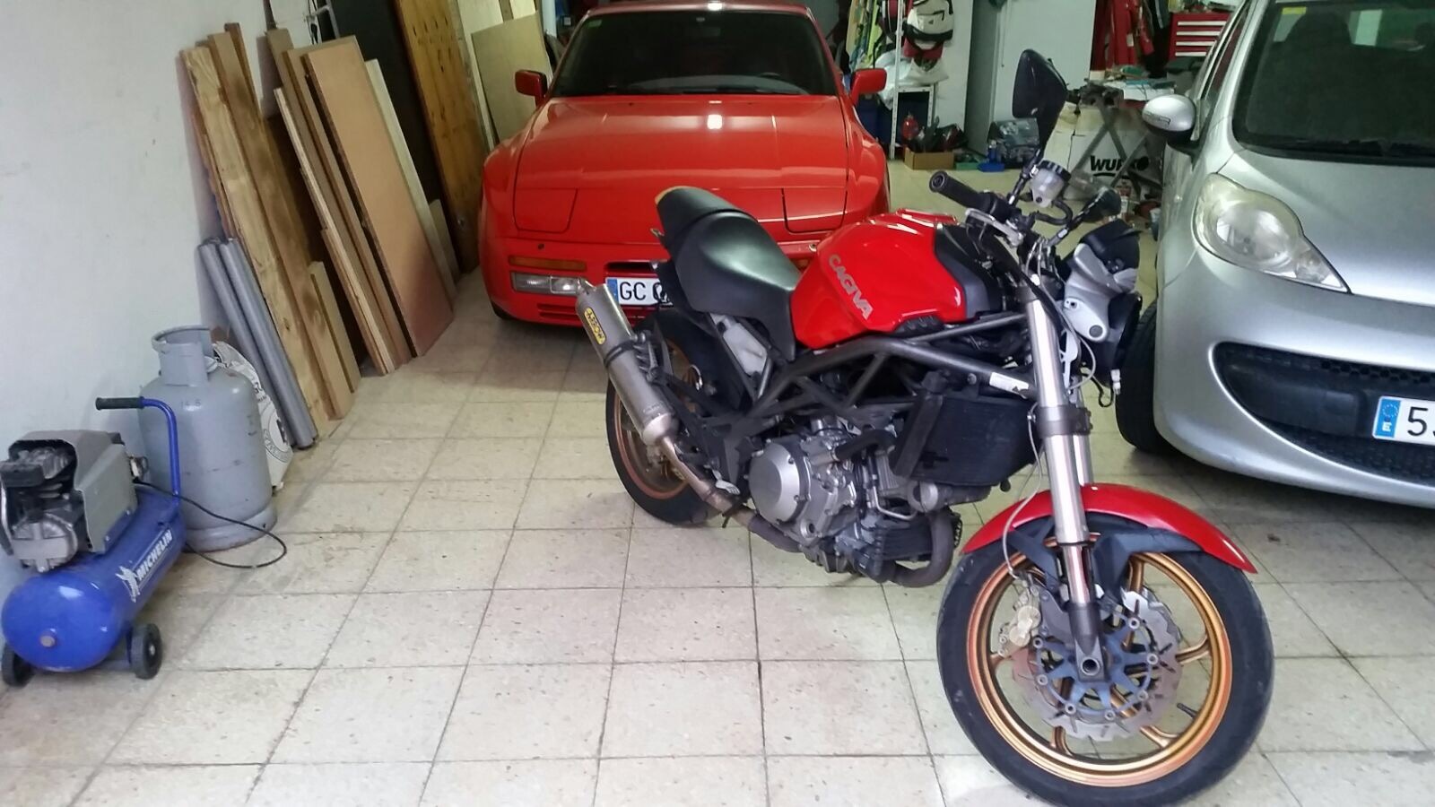

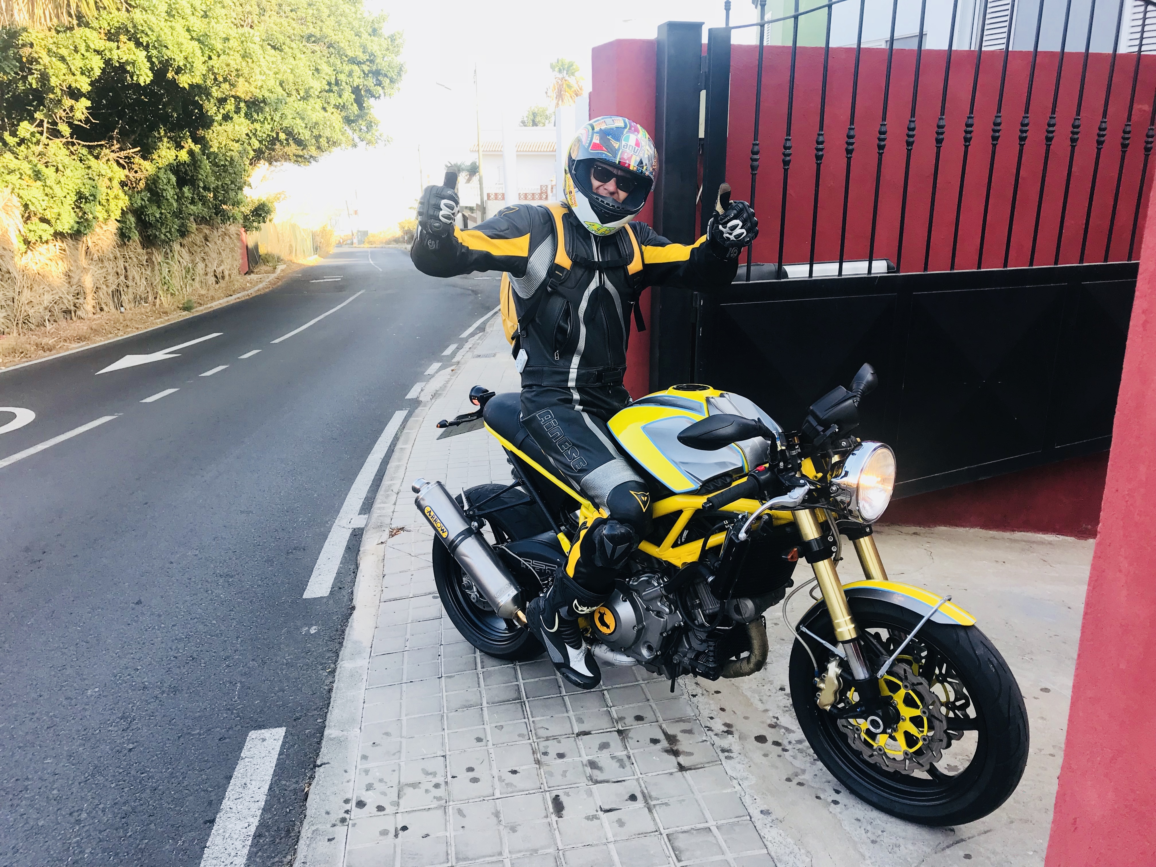

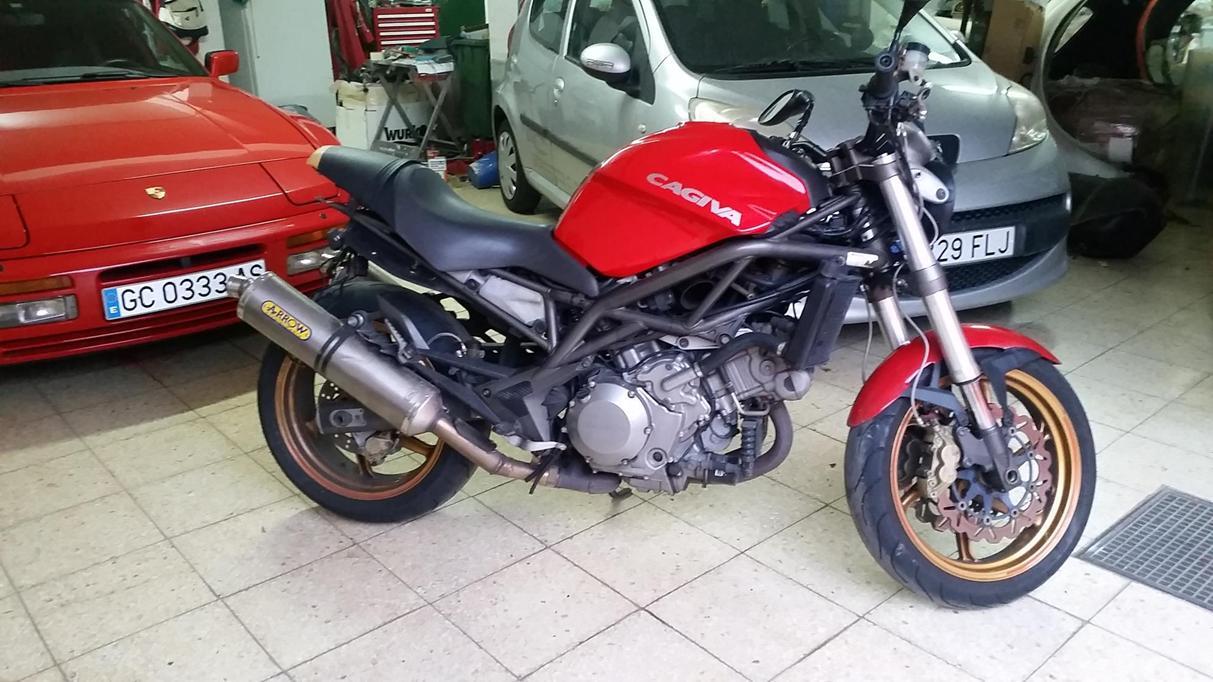

    678EDB1E-498B-4226-BE58-BBBA710E3EA2.jpeg 0E8BC73A-8CDD-4D23-BA60-A9E0BAB9230E.jpeg I bought this bike with a small rear impact who damaged de DME as this just in front of the rear light.
    The idea was to make a fun toy for my self, and it have been my favourite bike for going hunting up at the local mountain roads for last three years now.

    884

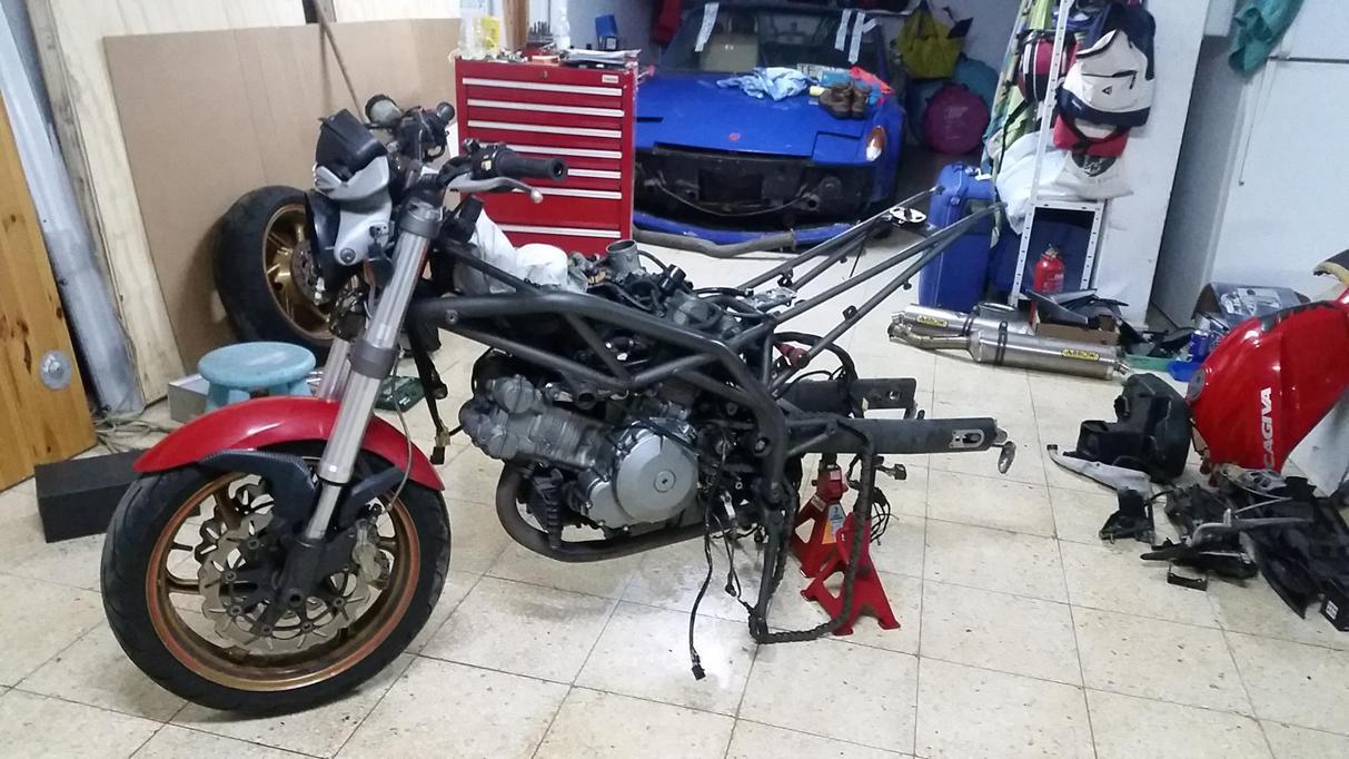

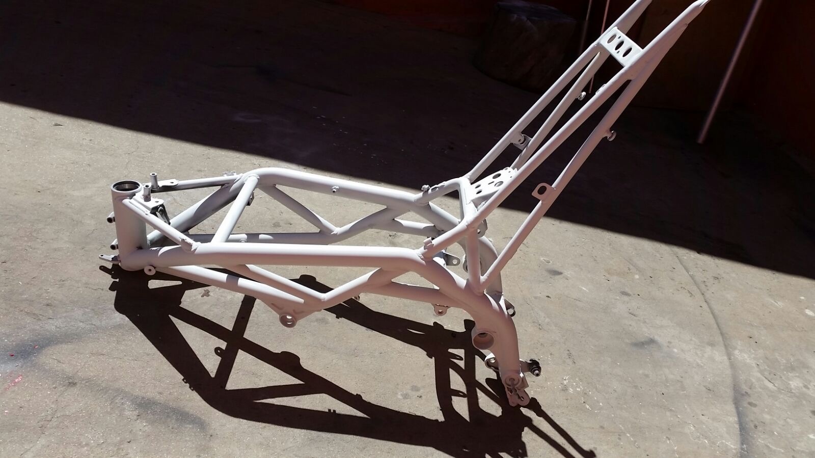

    First thing was stripping it down for inspección and day dreaming trying to figure out what kind of bike to build!

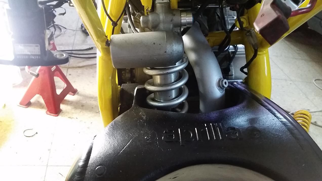

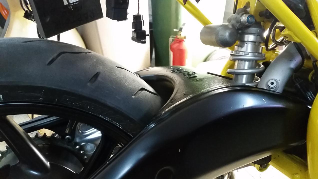

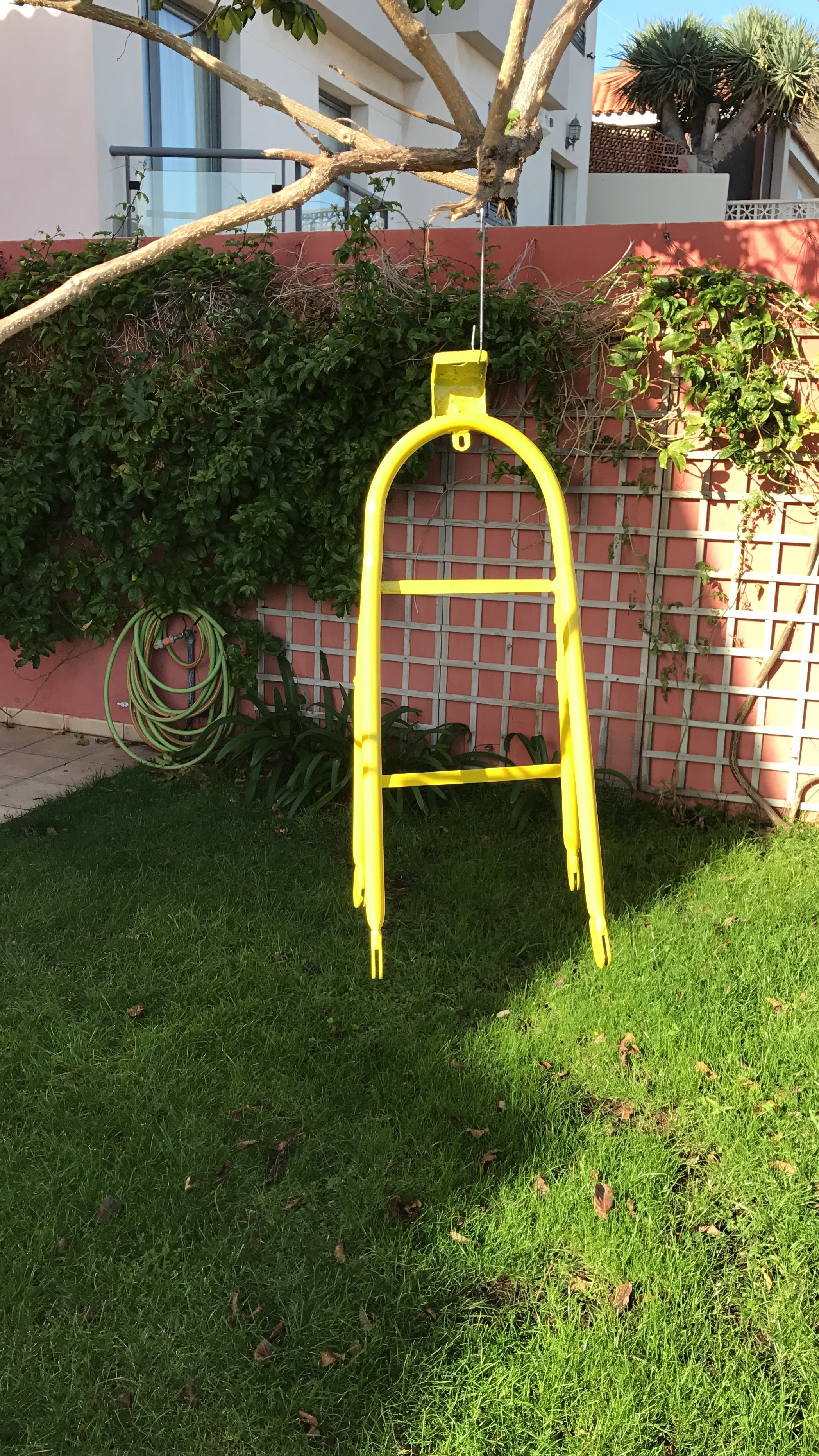

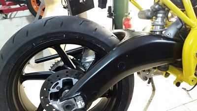

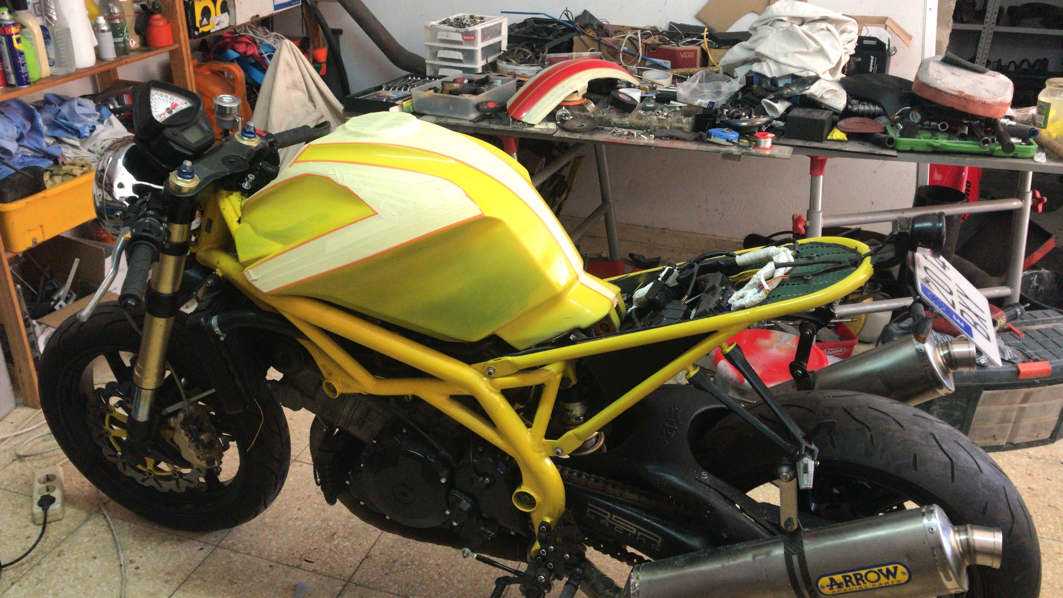

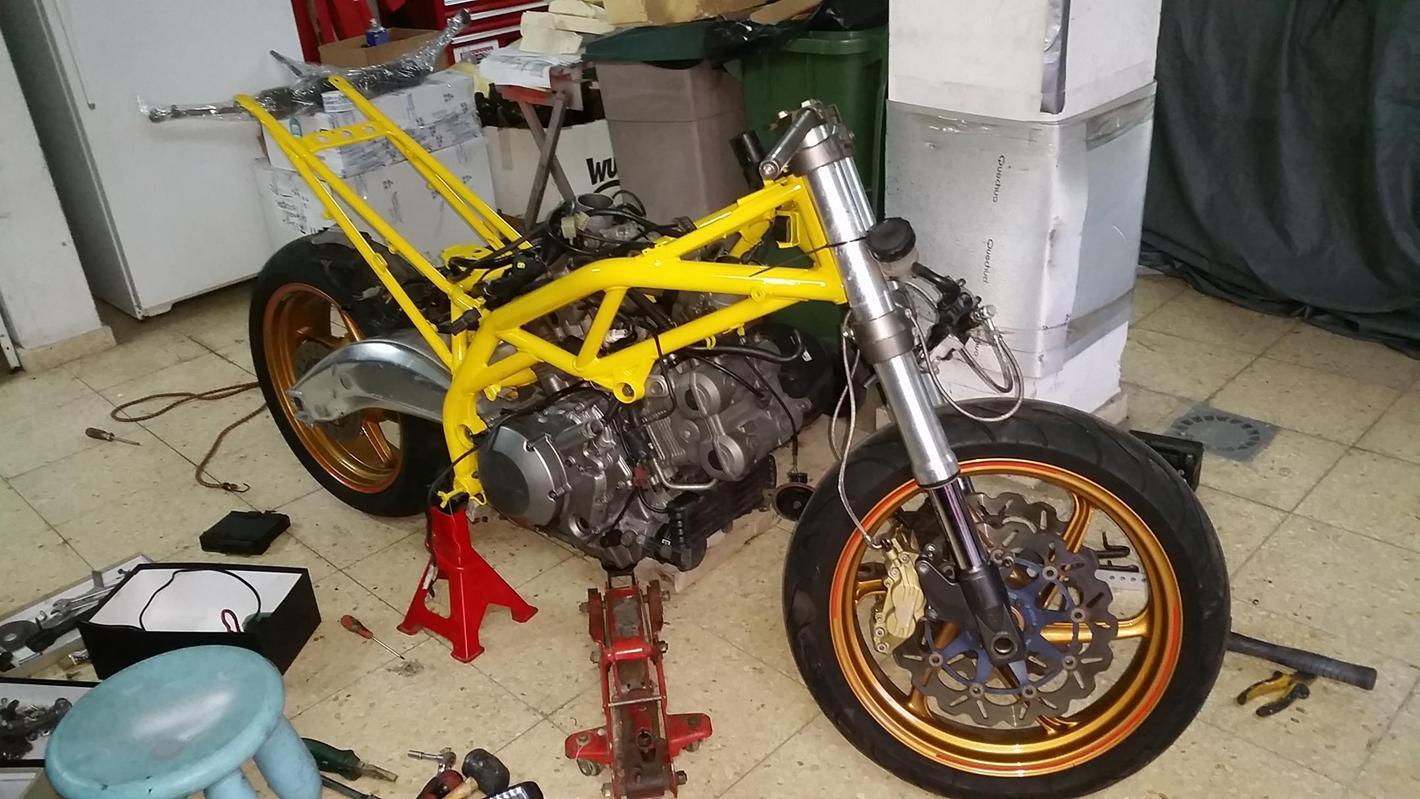

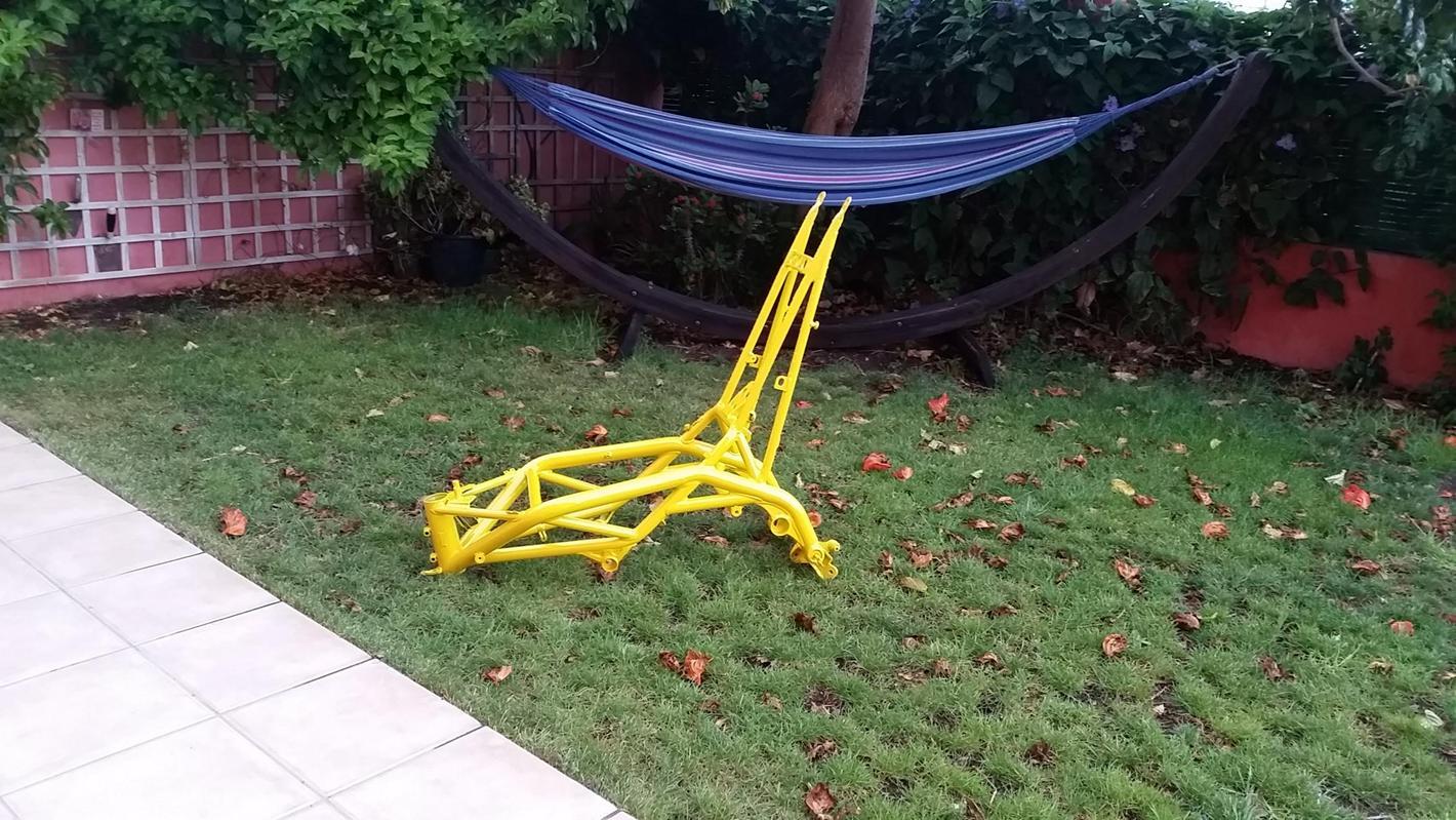

    What I had in mind was improve front and rear suspensions as the oem was from the economical line...
    Chassis was painted yellow and I found a cheap R1 rear shock at a local scraper.
    I bought used Aprillia RSV swingarm at eBay (from uk) and fitted it on

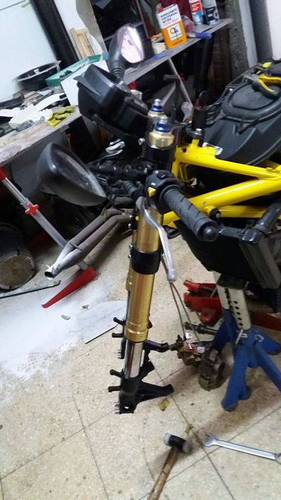

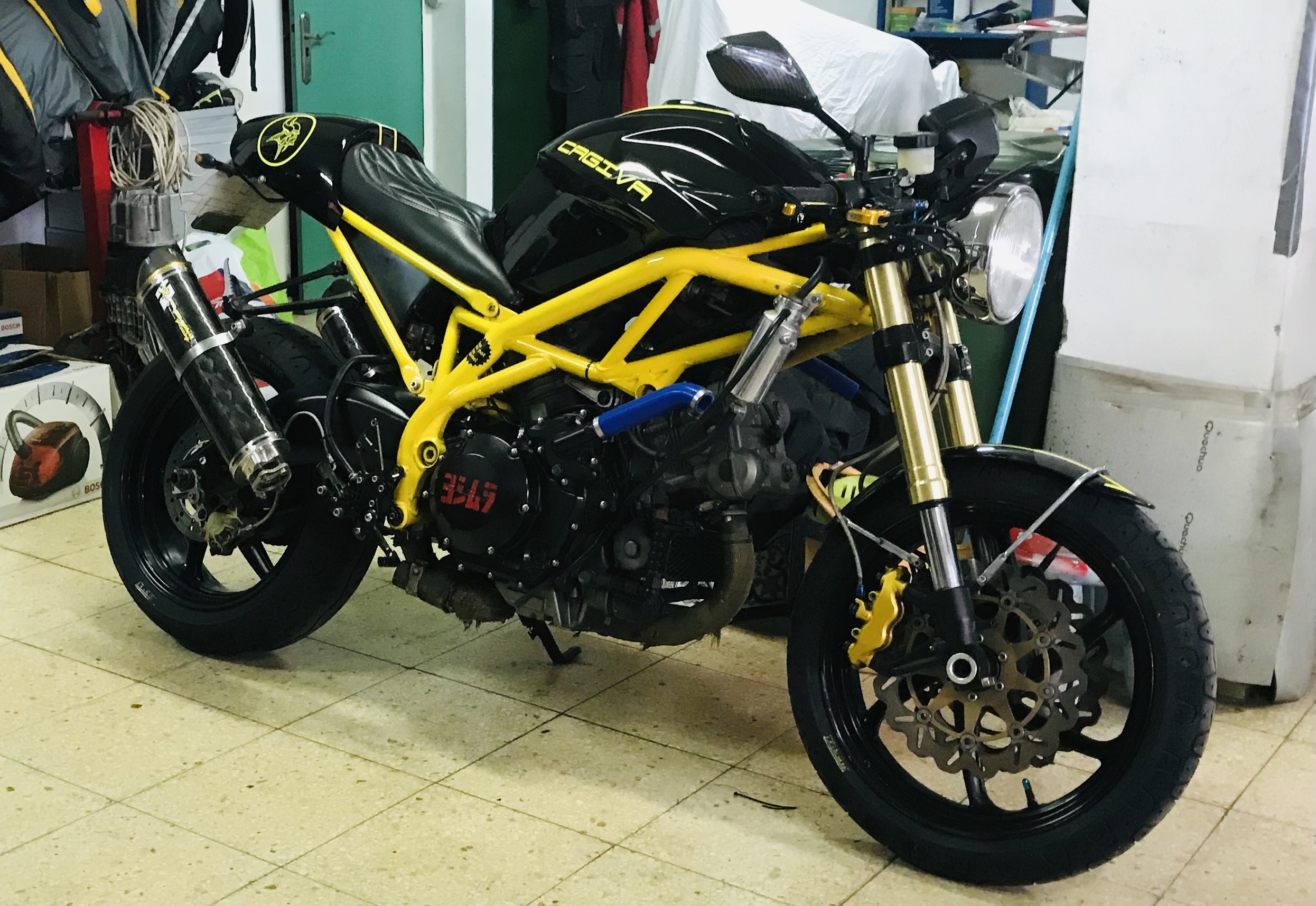

    FFD7159B-2F69-4B9A-A6EC-BC615F3354DF.jpeg Front fork and callipers came from a GSXR

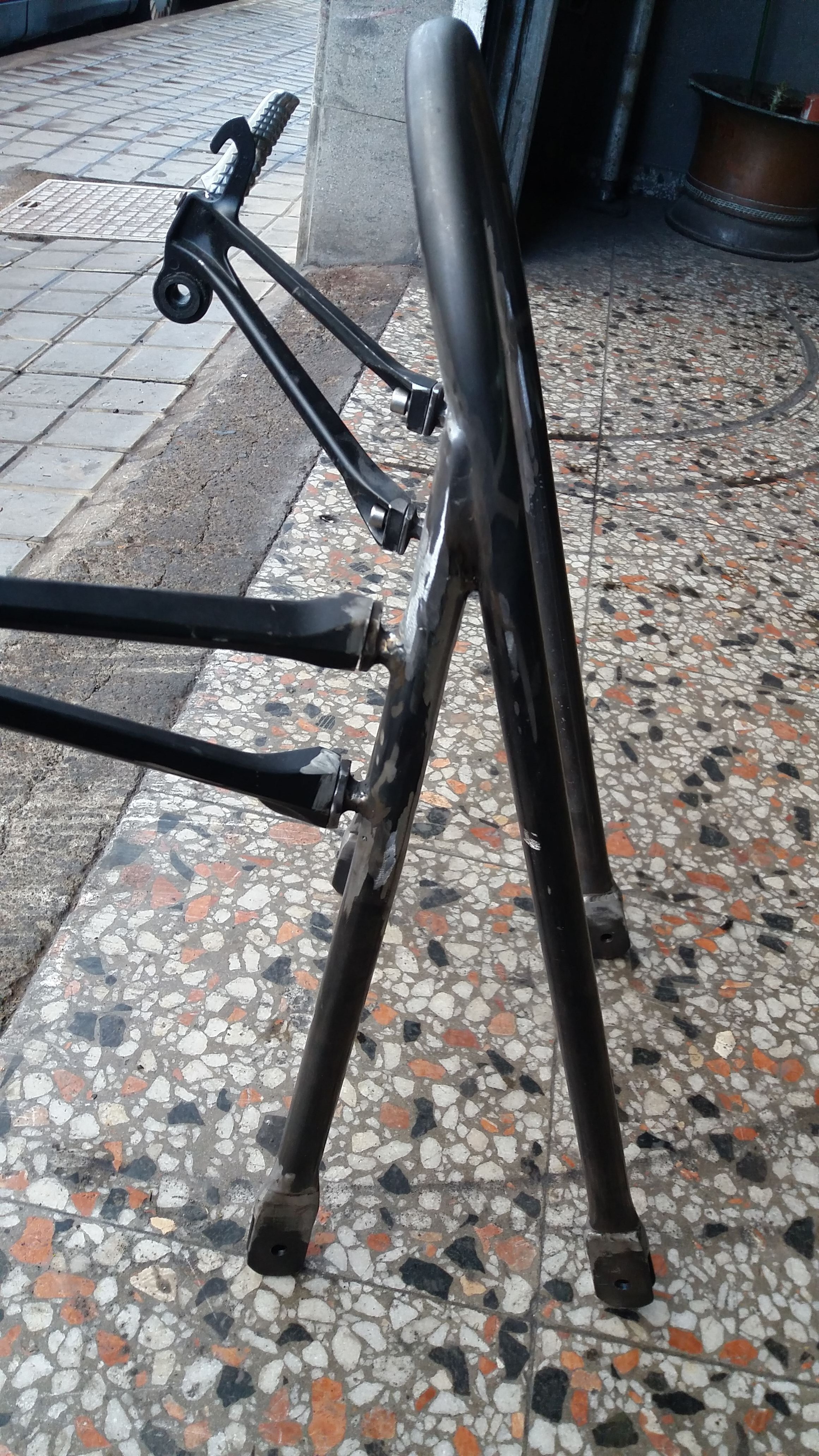

    As I didn’t like the angle on the rear frame I made a new one, but bolt on type as it’s help making mantinence more accessible.
    Fork was in place and the bike was at the ground again on its own wheels again

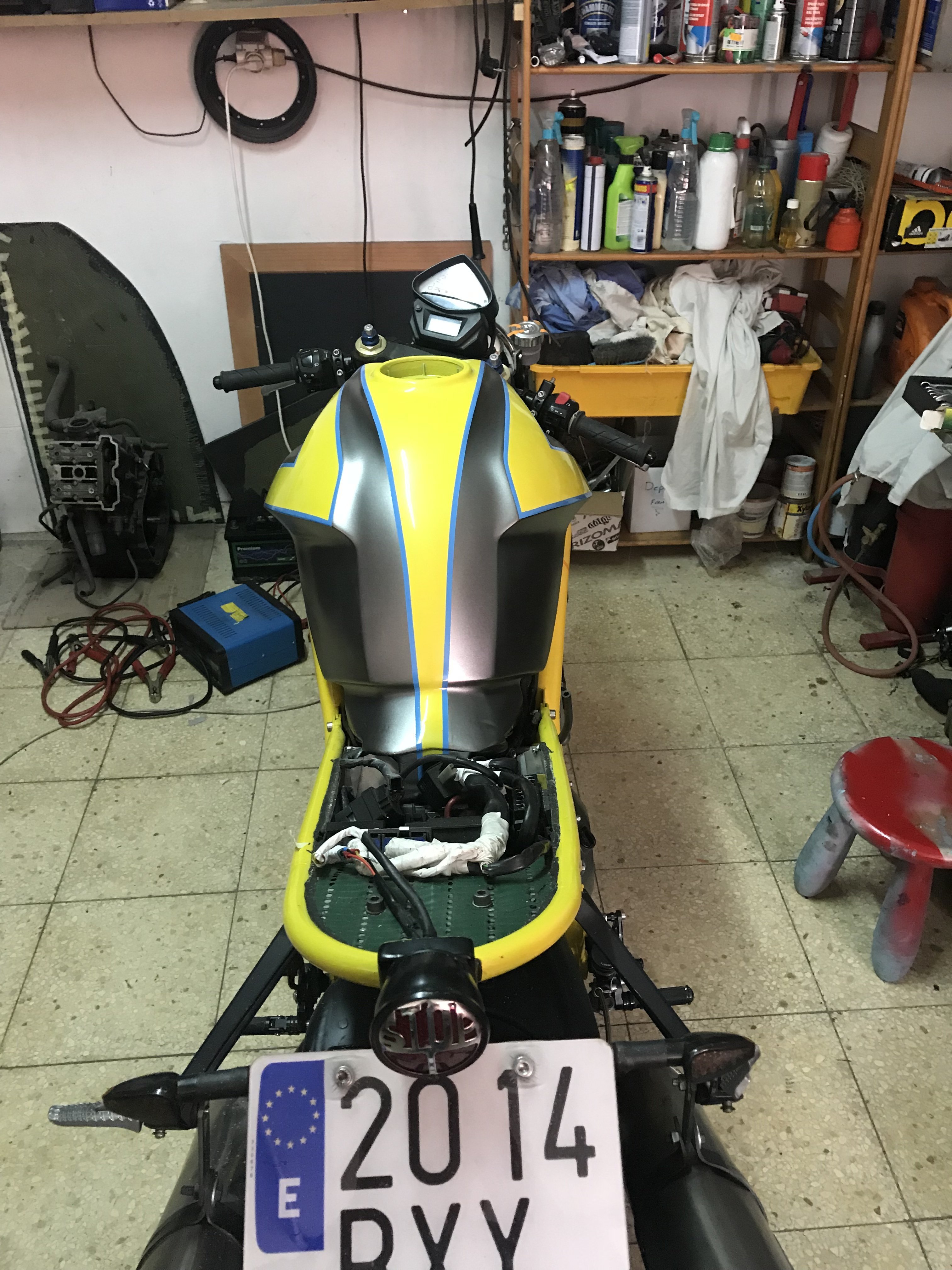

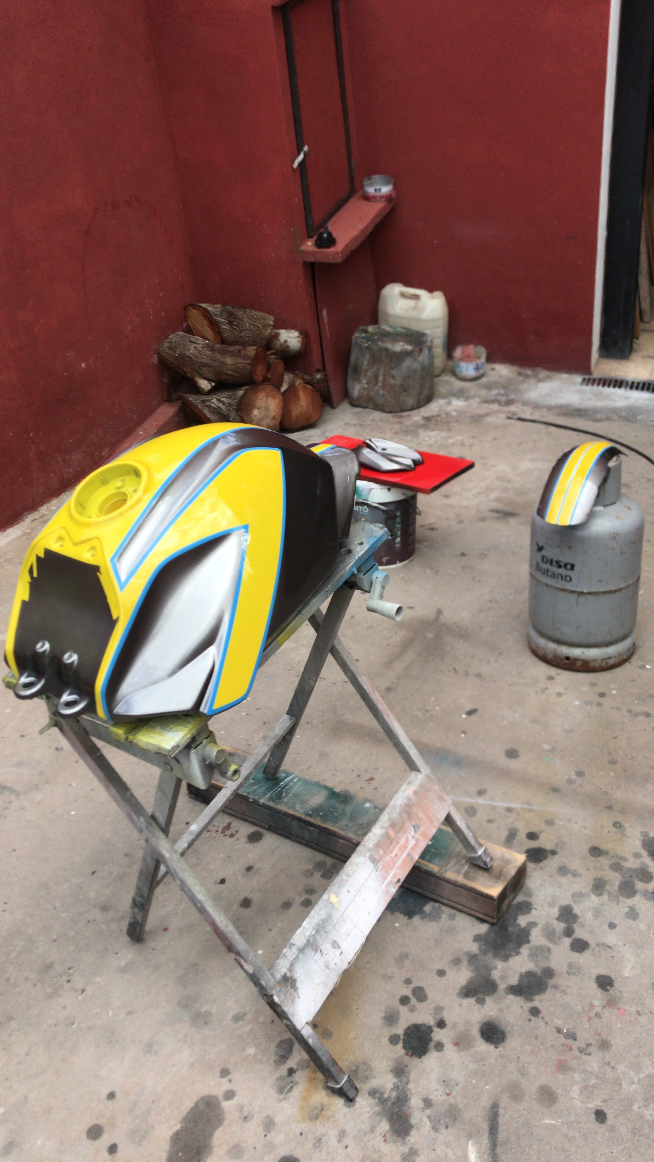

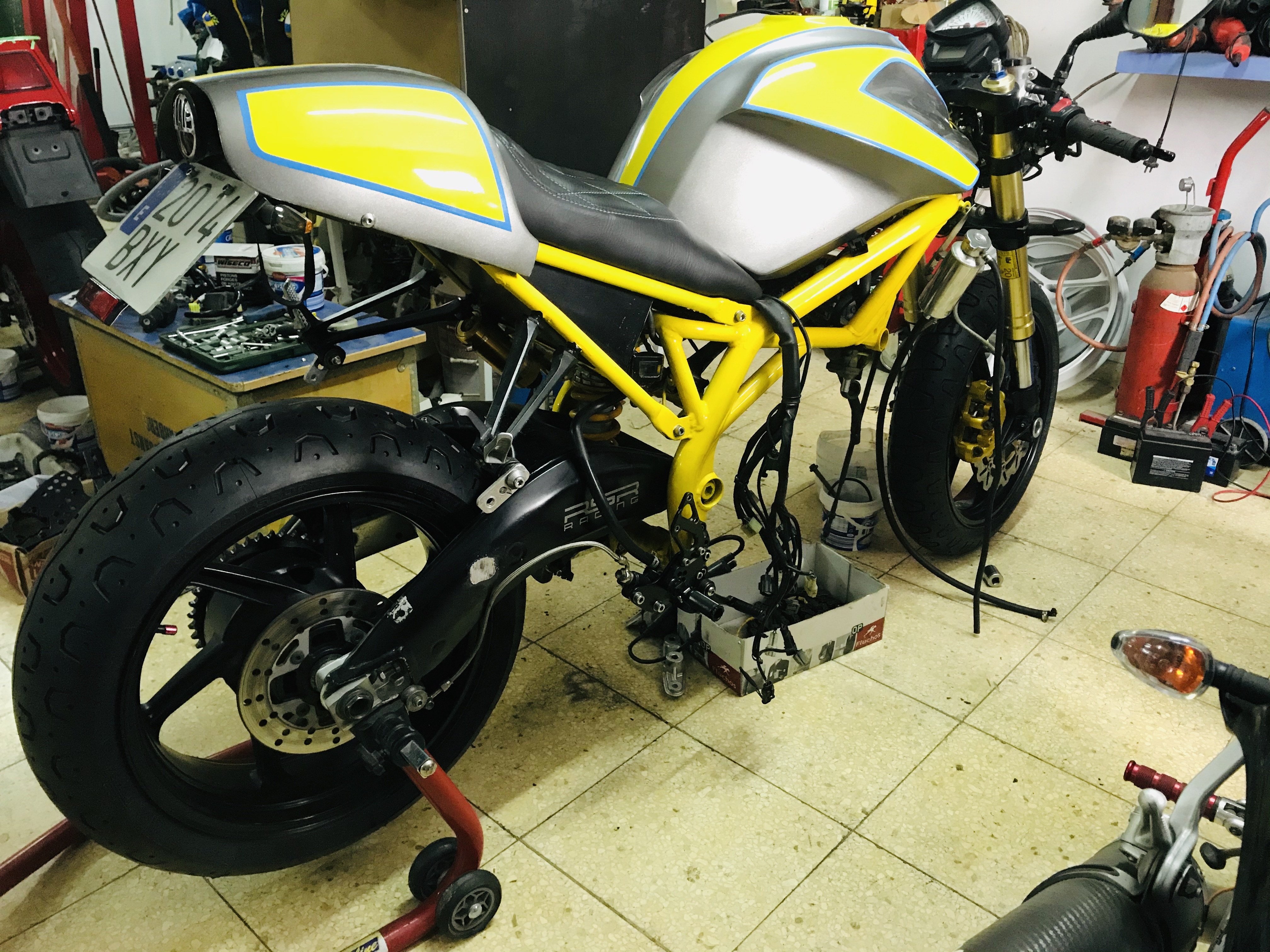

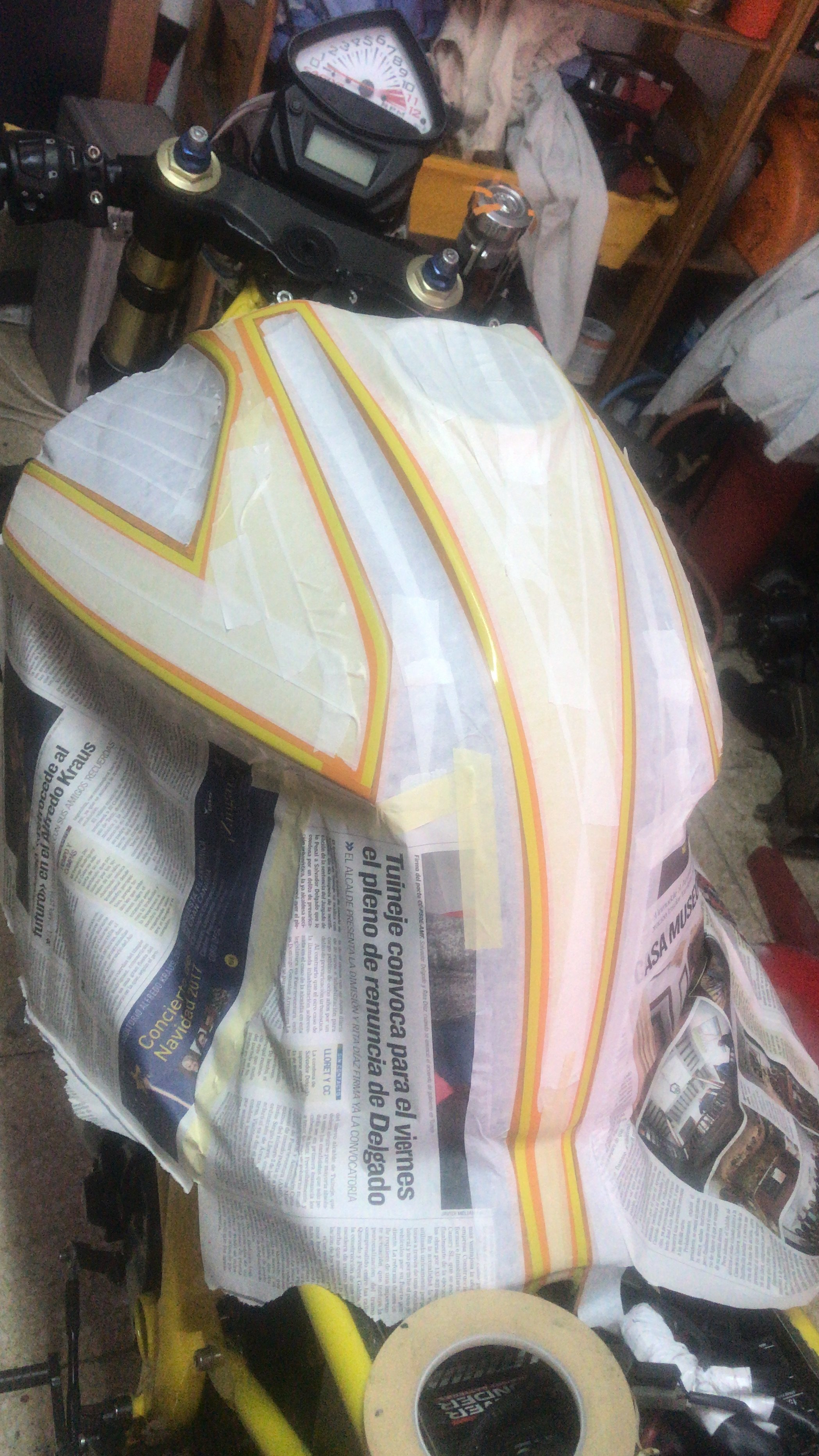

    This time I had in mind making a little paint tribute to my Swedish/Gran Canarian past as both has yellow/blue flags.
    1C8AC1E7-256B-4AC2-893F-71CEE9D82A77.jpeg 22596DE5-420B-4FA0-889A-10DFAEC40421.jpeg 74033CA2-1BAF-4601-B93B-3EB2D9AC3E1C.jpeg As usual I make my own garage painting... 702233CF-ED72-4DE8-8737-058D36BE7727.jpeg

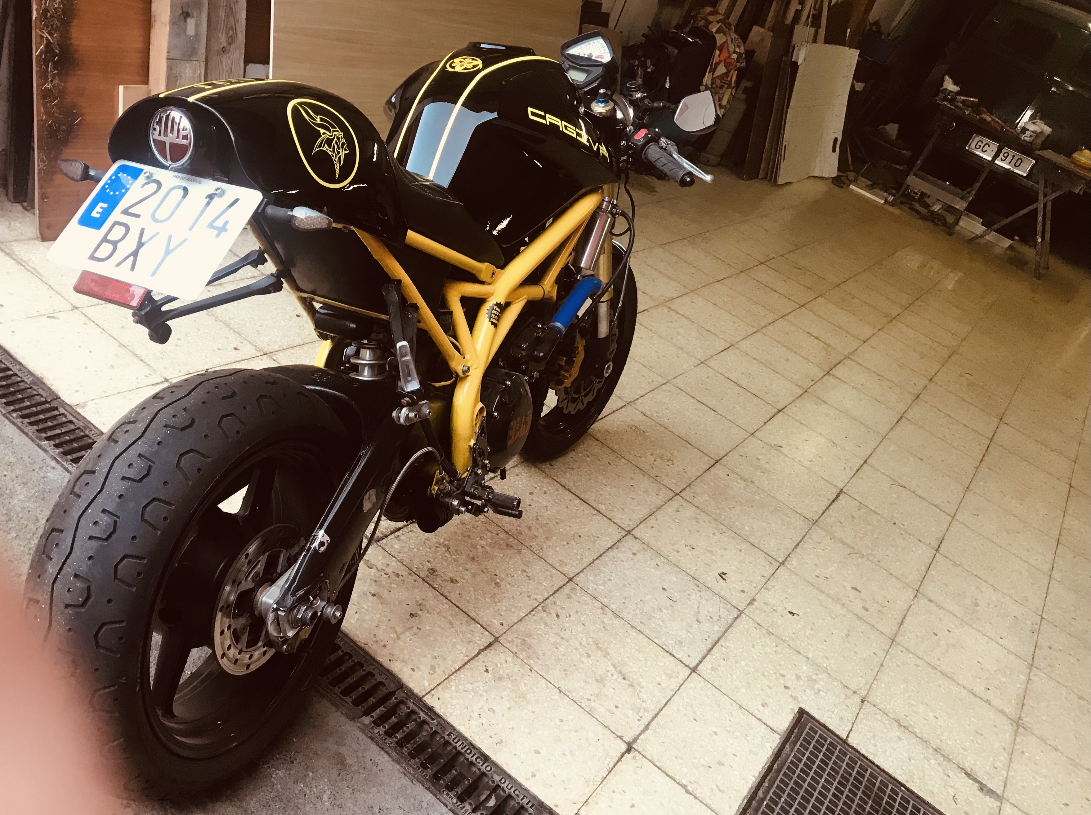

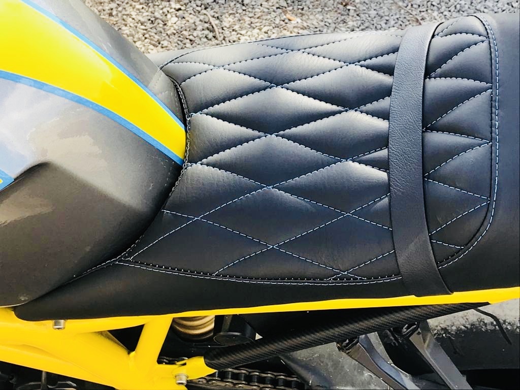

    I use make my own tailor made seats as this way the fits as I want.

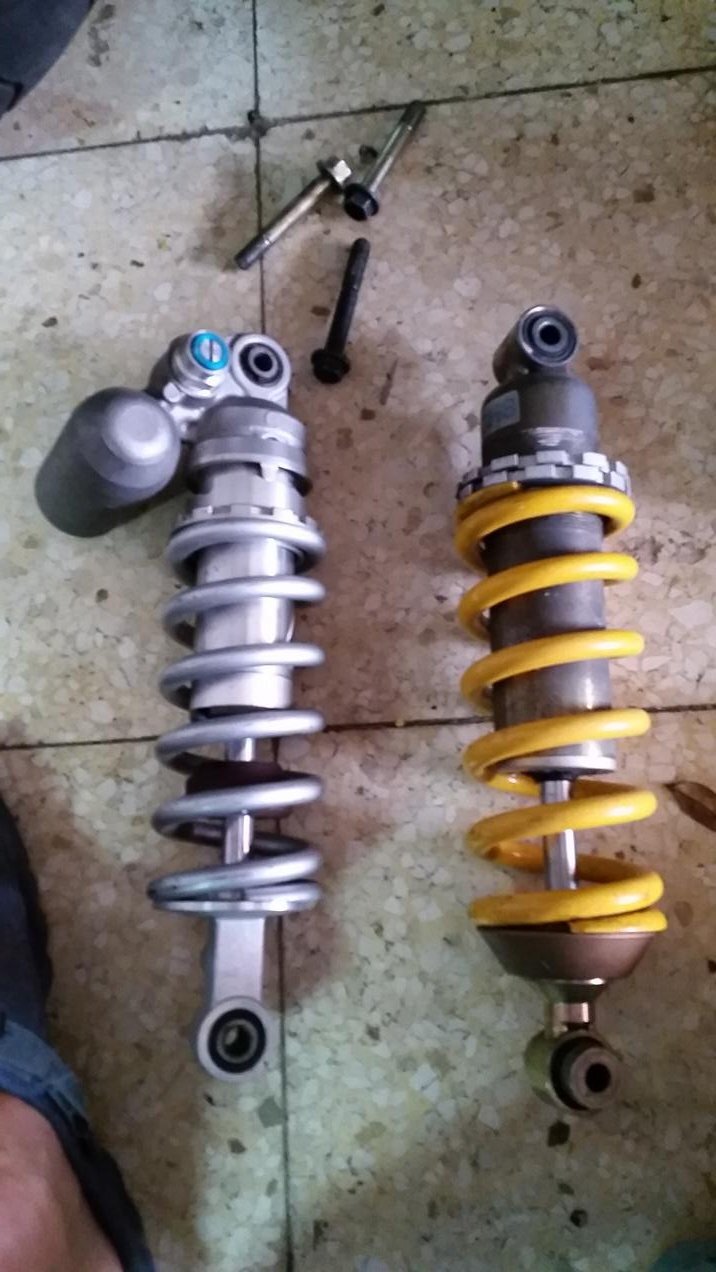

    The bike was ready for first rides and it was great!
    It had a bit to much spring load at the rear, making the wheel bump and loose traction on irregular tarmac

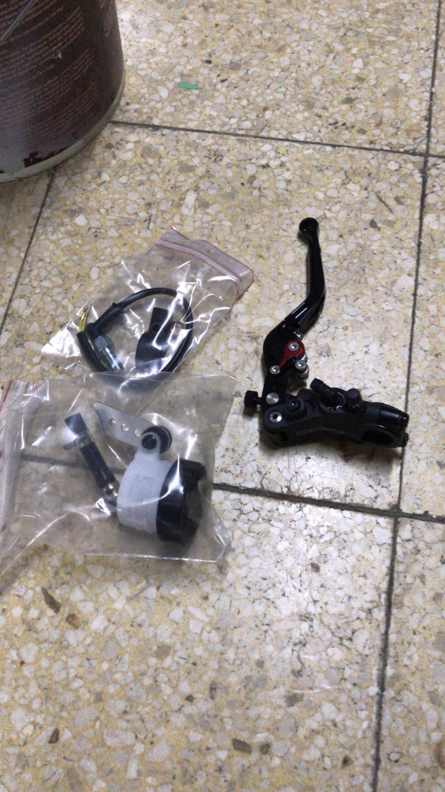

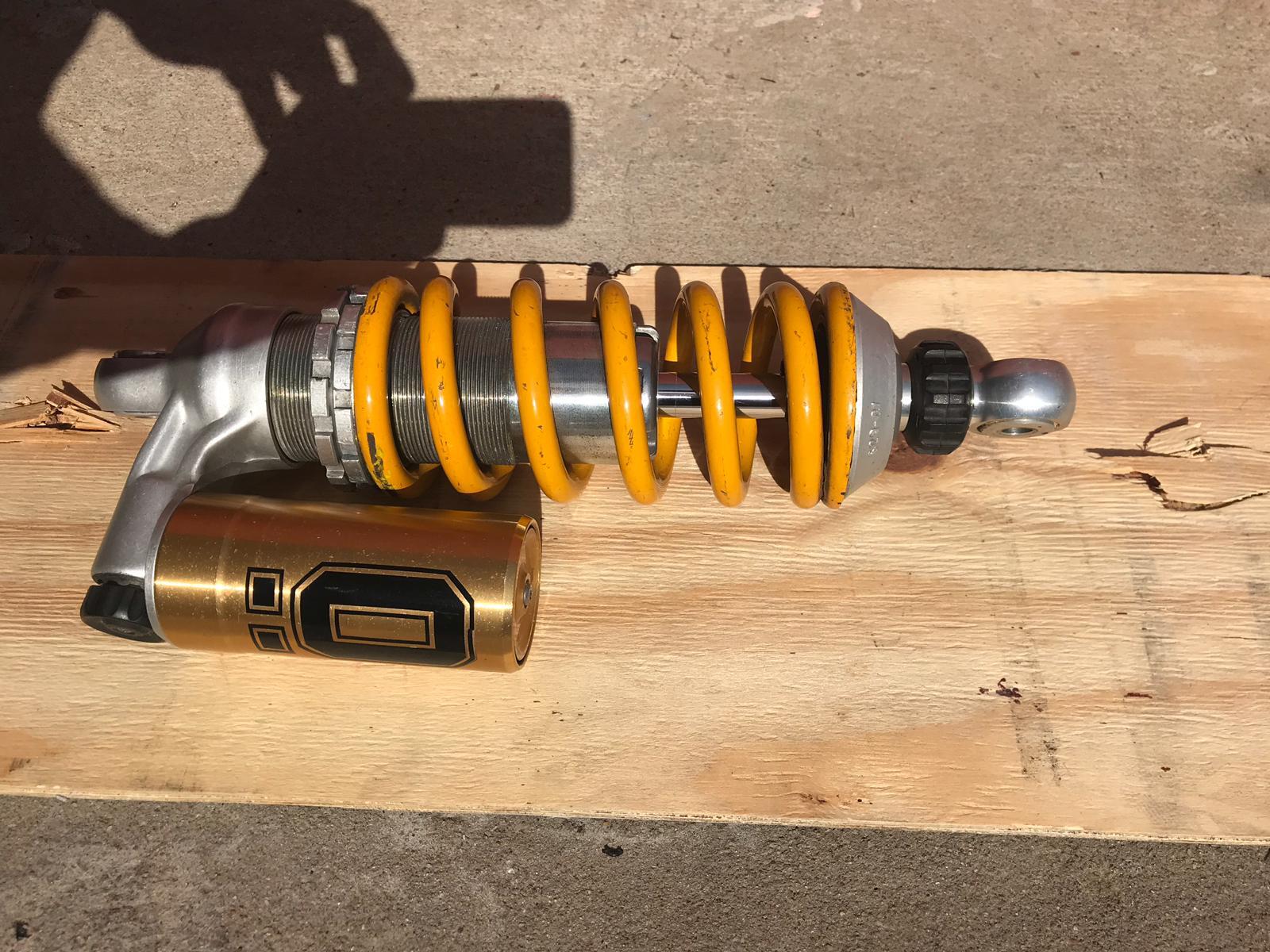

    Front brake was improved with a radial brake cylinder and rear suspension with a Öhlins

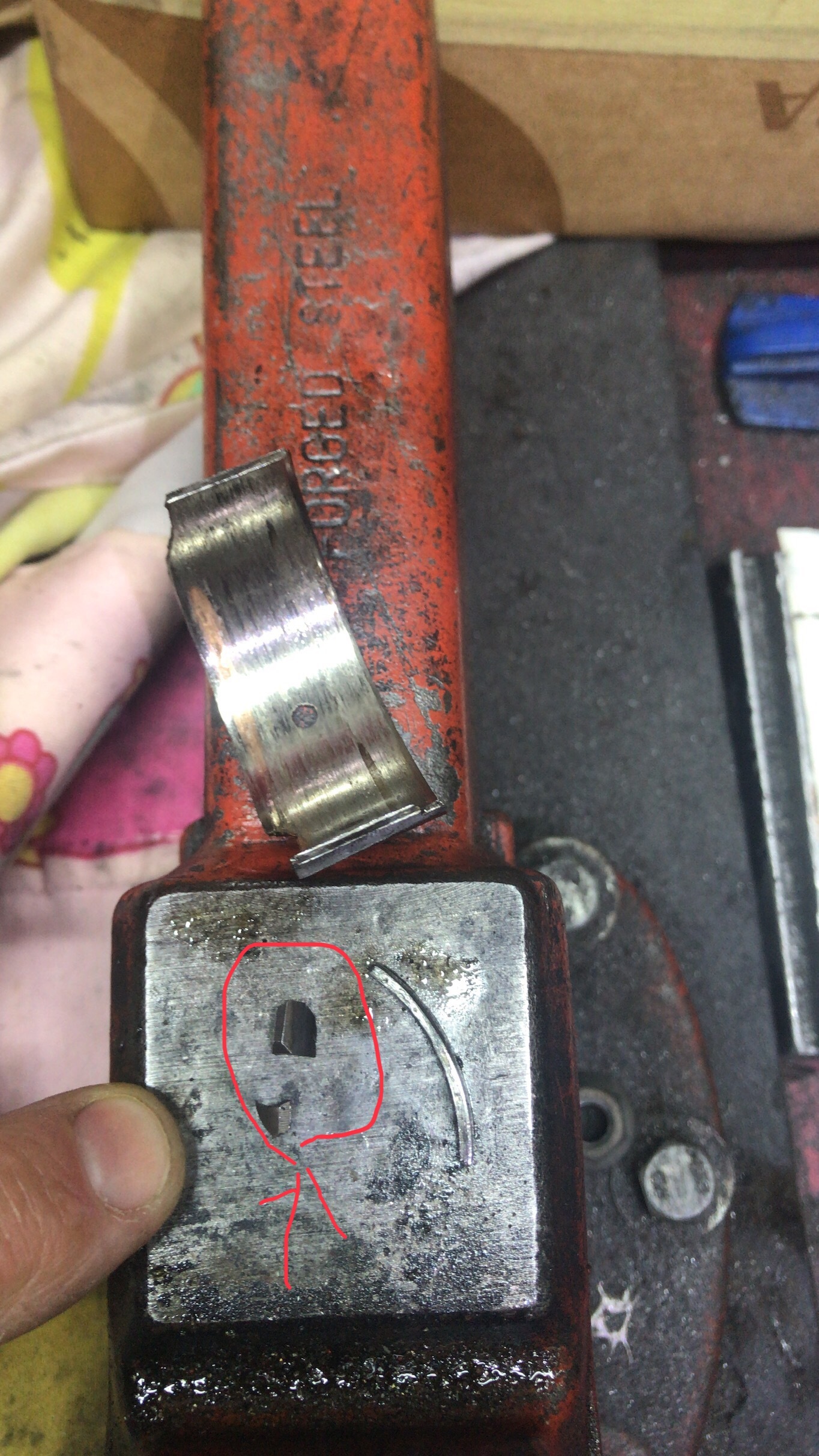

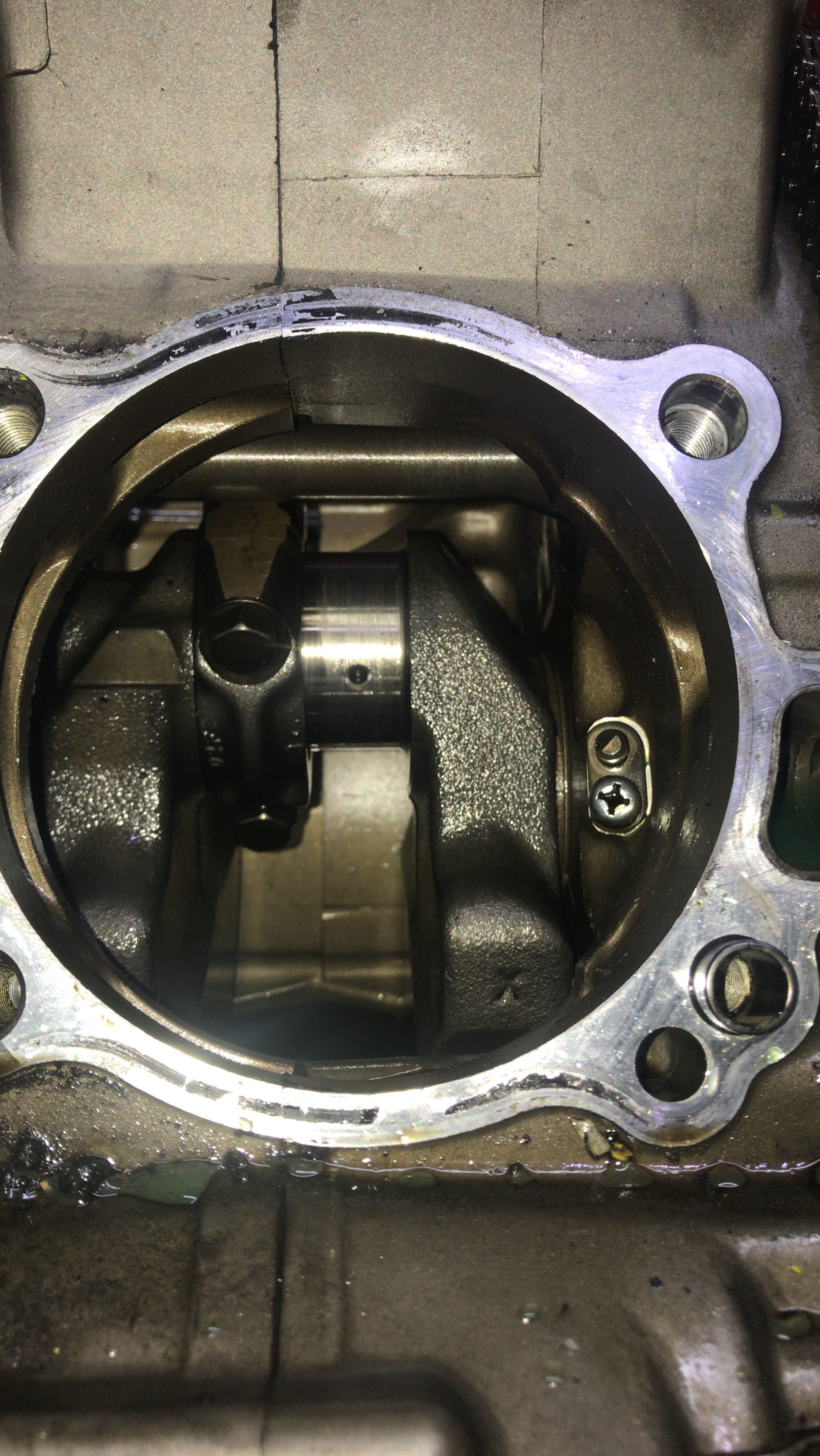

    The bike was used daily during more then one year before I blow the engine, it’s was needed new pistons, rods and crankshaft.
    I found a used crankshaft and forged rods from US at eBay for 150€ .
    New forged race pistons came on for 700€ ...
    Gaskets 140€
    A lot of money but for a low budget bike..

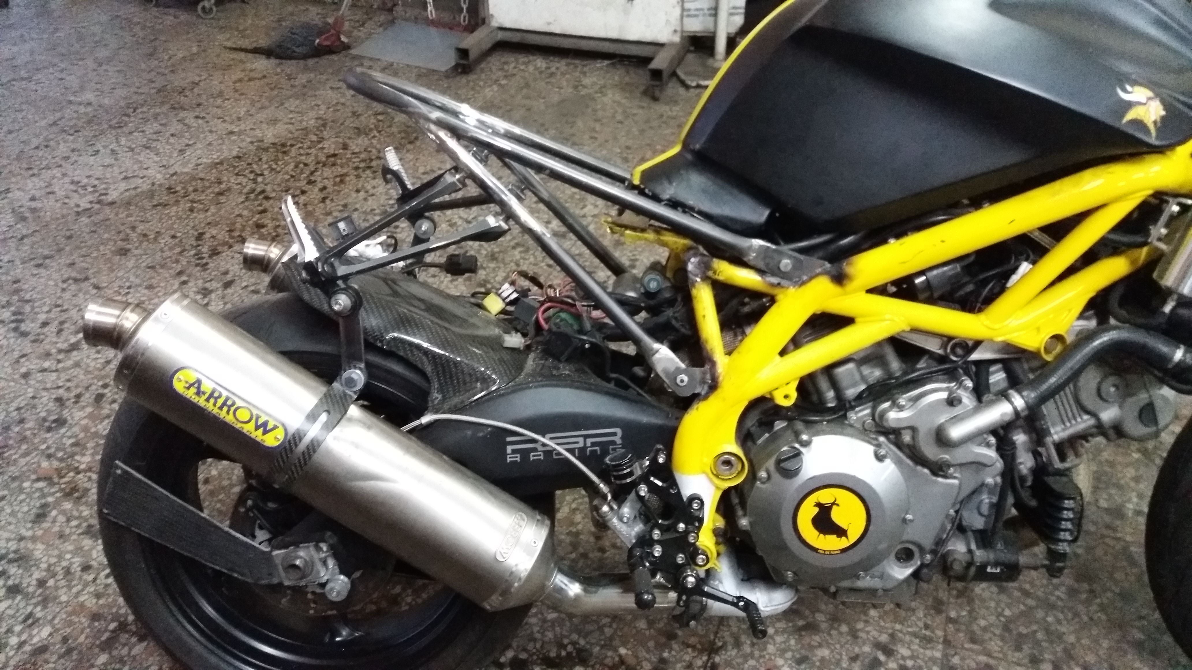

    The 28 of June I hade an accident with the Raptor, the bike wasn’t very damaged just some scratches and minor repairs,
    I’m still recovering from it but I believe I will not have the enough force on my left arm/hand in the future for this kind of crazy bikes, So now on its time for “ride the wind of change”, that’s the reason why I bought my first classic bikes a T140D and a 1976 Ducati 900SS.
    But first I have to finish this little Raptor , A friend of mine says he want her so it’s time to sell the bike!

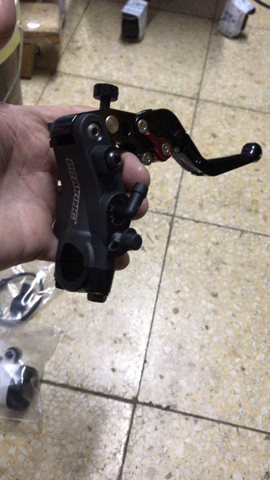

    Today I prefitted the silencers, Swapped the front brake cylinder and started the engine for first time since June. 0DEBDEA1-A6F5-4936-BD9C-D2DD78248CE9.jpeg 041BA021-E1DE-4261-A550-C3DC3D45AA65.jpeg

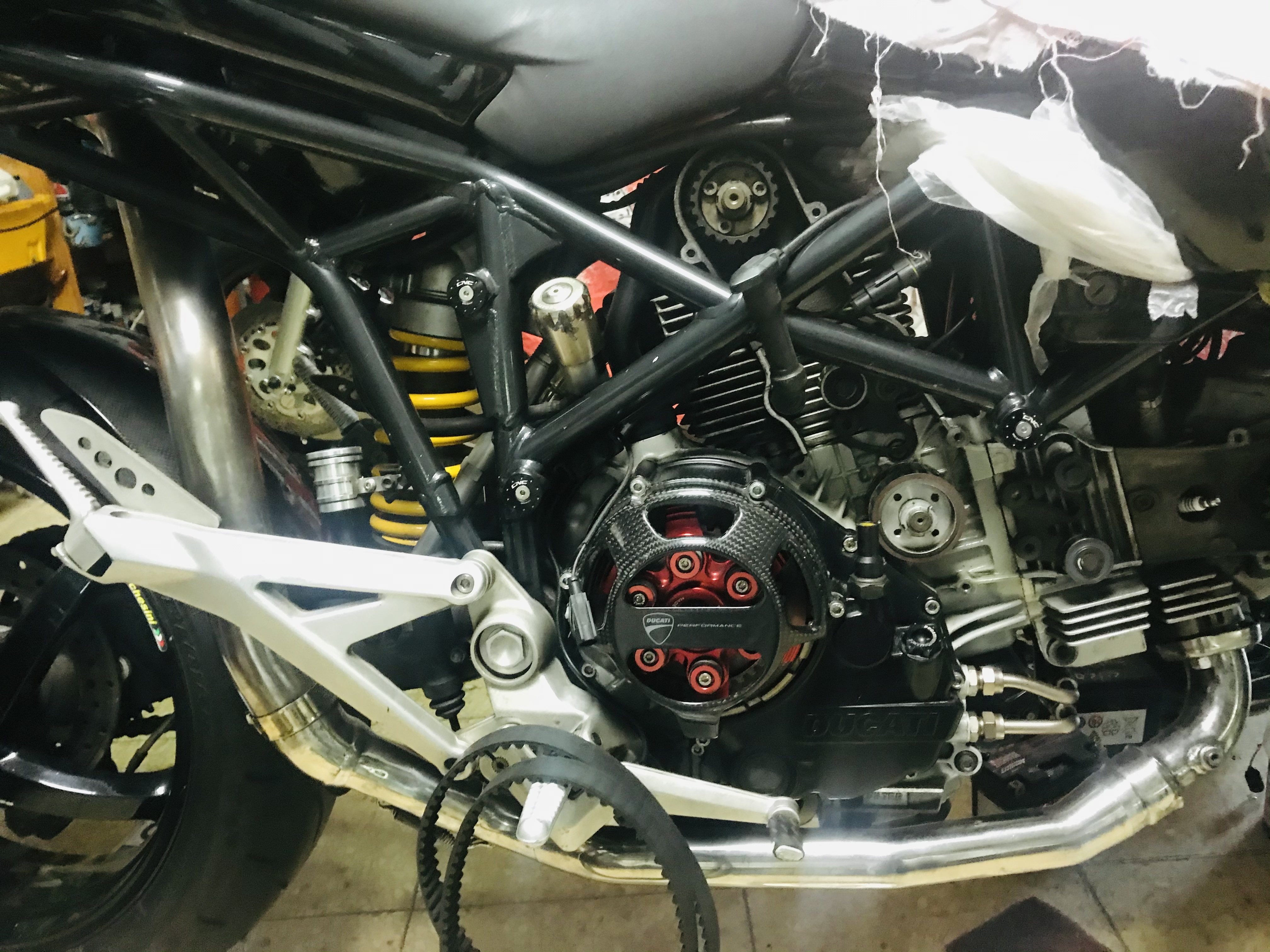

    This afternoon I changed timing belts at my other bike E5B6B44F-1541-464E-9F3D-23E0A428F875.jpeg
