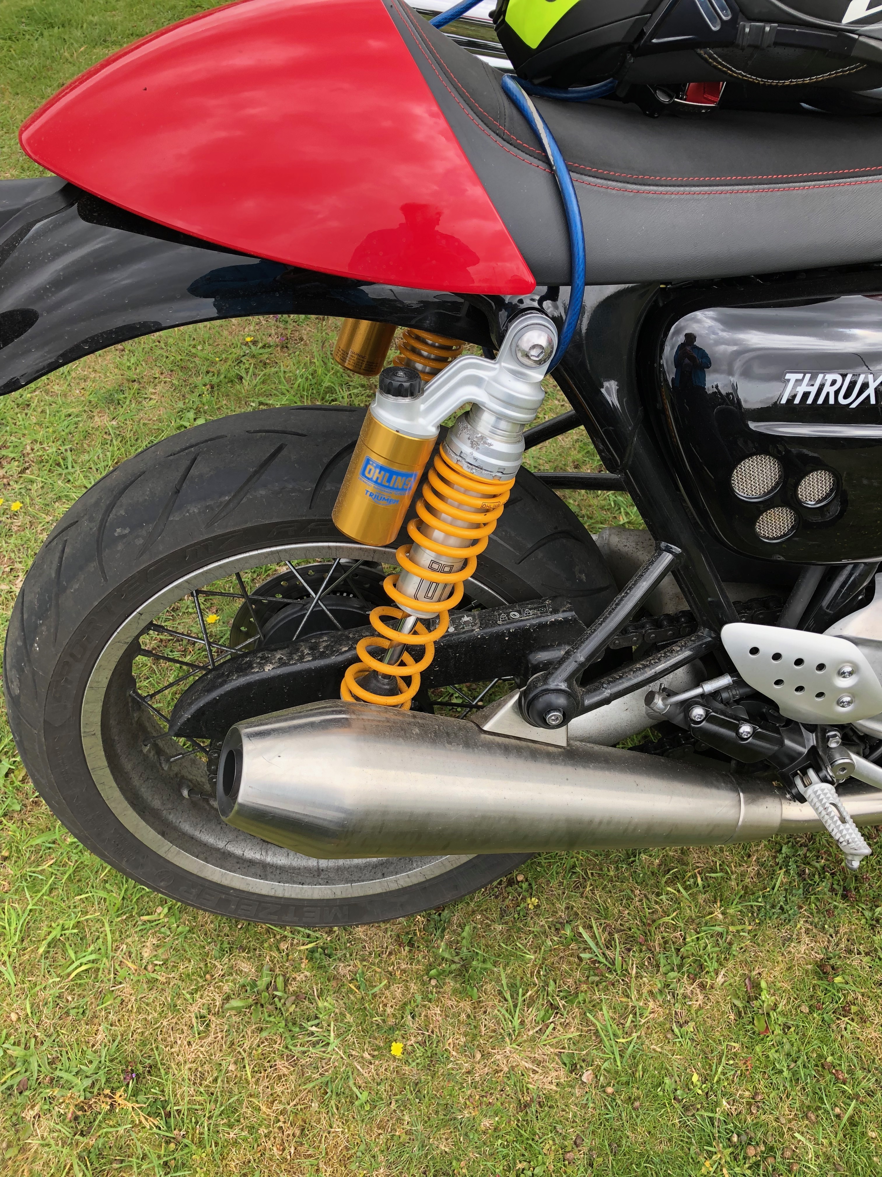

    I think you are right. I showed this photo of the corrosion on this Ohlins to a man in the business. He said that these OEM parts are often made under licence so not necessarily by Ohlins themselves.
    I guess it's the same with the disks. They can be made to Brembo's design / drawings by others, but without the quality of materials and machining. But it's Triumph that should check each and every batch.
    I've done just over 1000 miles and no probs yet touch wood.
    I saw this parked up at Popham recently.

    Was it parked in the sea a couple of weeks before:p

    Yeah it does look like a sacrificial anode!
