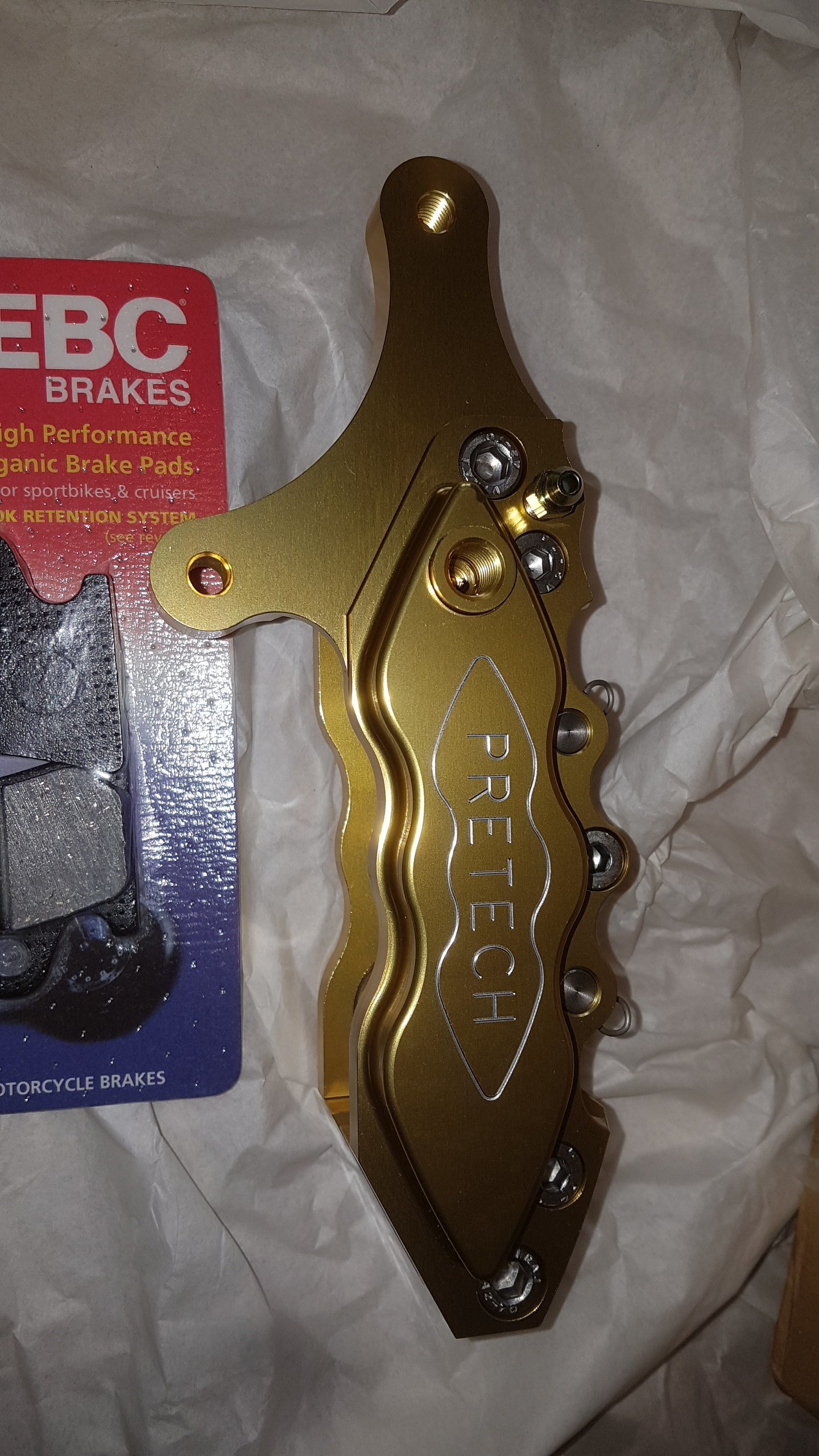

    Fitted a Pretech last month, transformed the mediocre OEM fitment

    I opted for the Pretech when I had my air cooled Bonny.
    When being deliberately stupid I could lock the front wheel using just one finger. Straight out of the box it was good but it took a lot of careful work on the fork lugs and shims to sit the calliper parallel to the disc in both planes for absolute braking efficiency with all six pistons pushing square onto the disc.

    I have a CBF1000 caliper on my T100 and it's twice as good as the standard, probably more so as the standard is piss poor. I bought one of the sets in the ebay listing above for my SE and it is fantastic, brand new and massive improvement. If I was buying again I would buy the one from Italy everytime, don't waste your money on Pretech they are way too good for the performance of these bikes.
