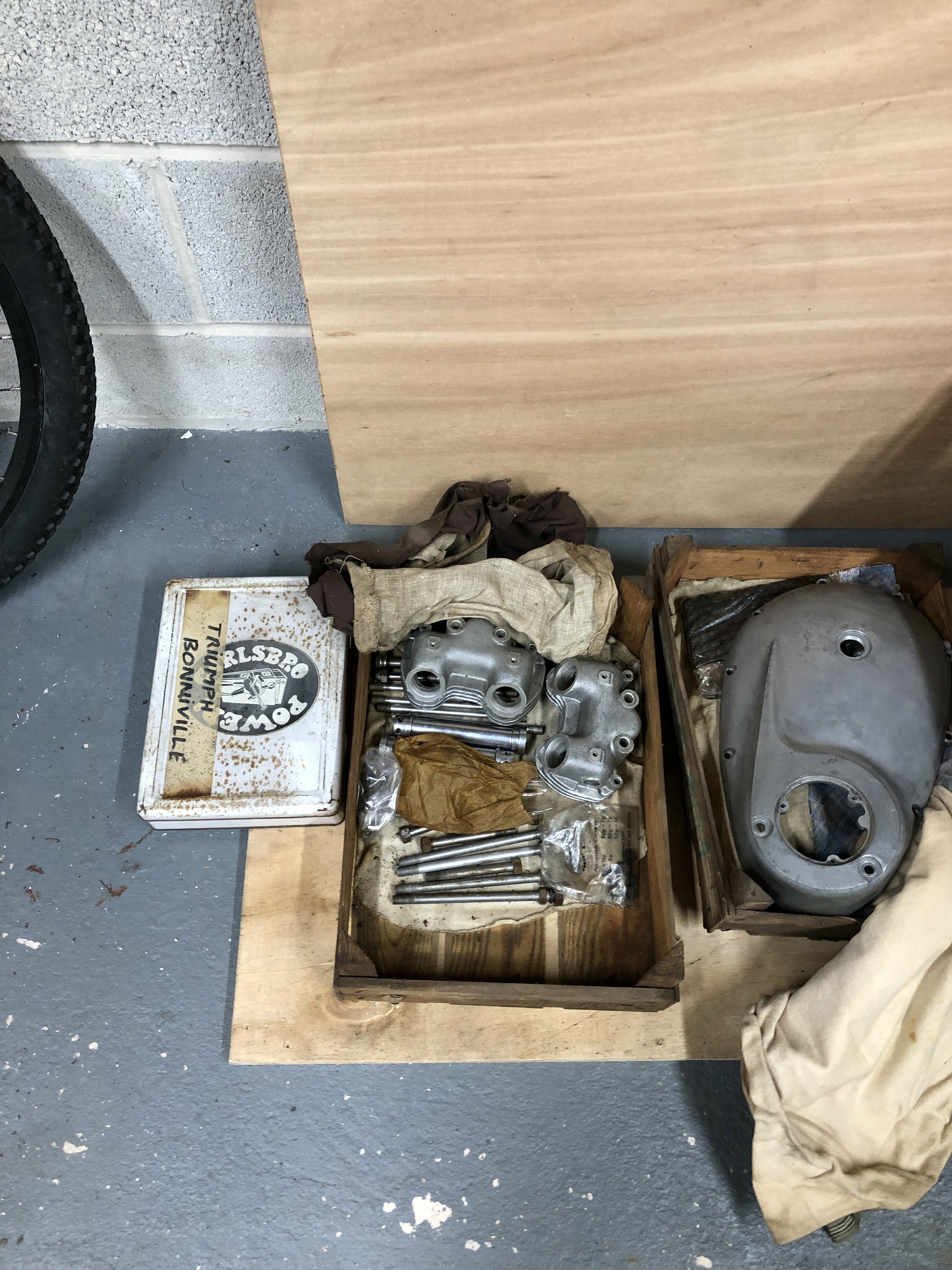

    And so it begins :eek:

    Great ! The more resto threads the better . Will look forward to following your progress and wish you and your project well . Goes without saying theres some very knowledgeable guys on here and I have certainly received good advise along the way :) . Did you buy your bike in bits ? or have I missed the story somewhere .

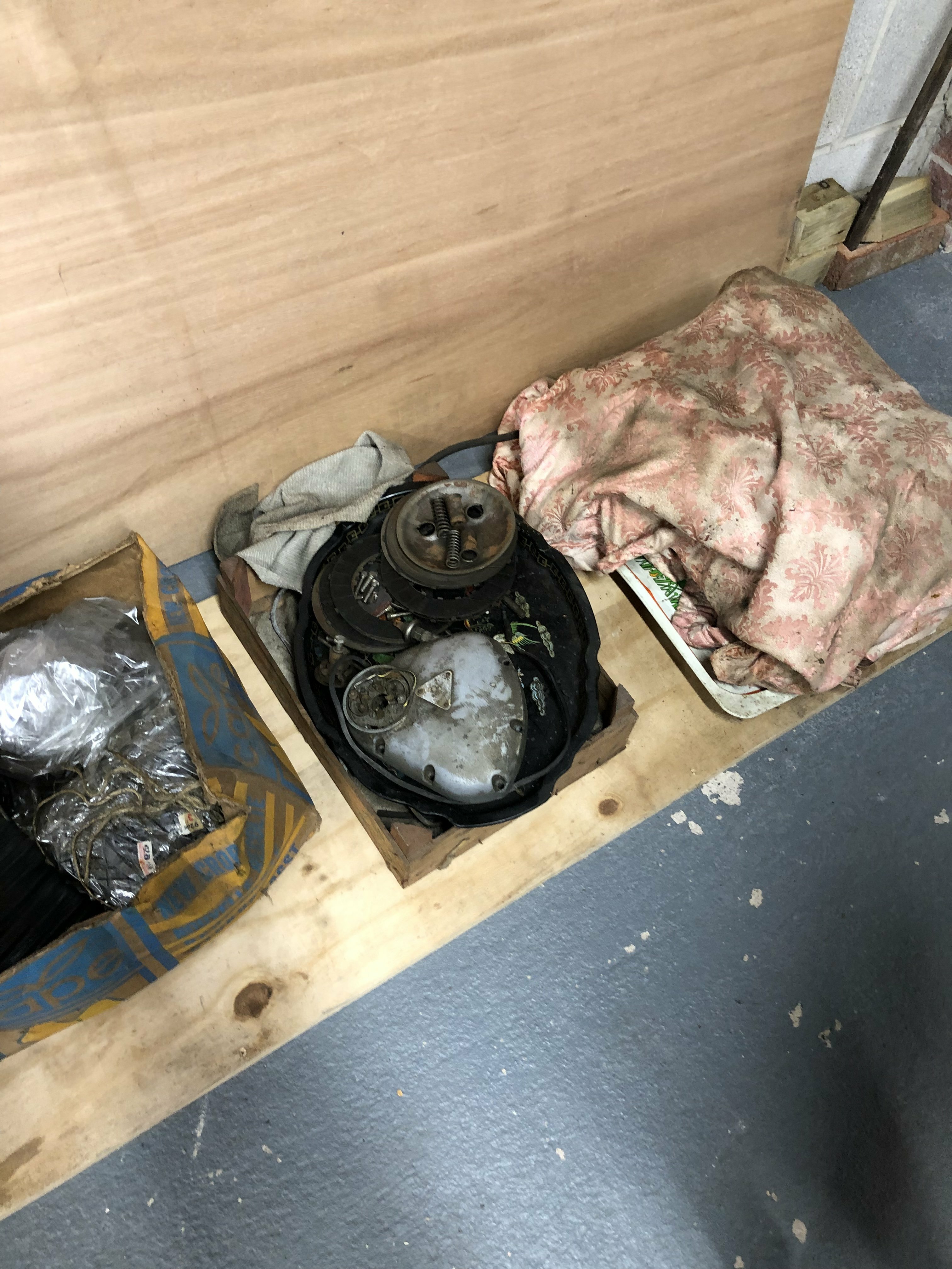

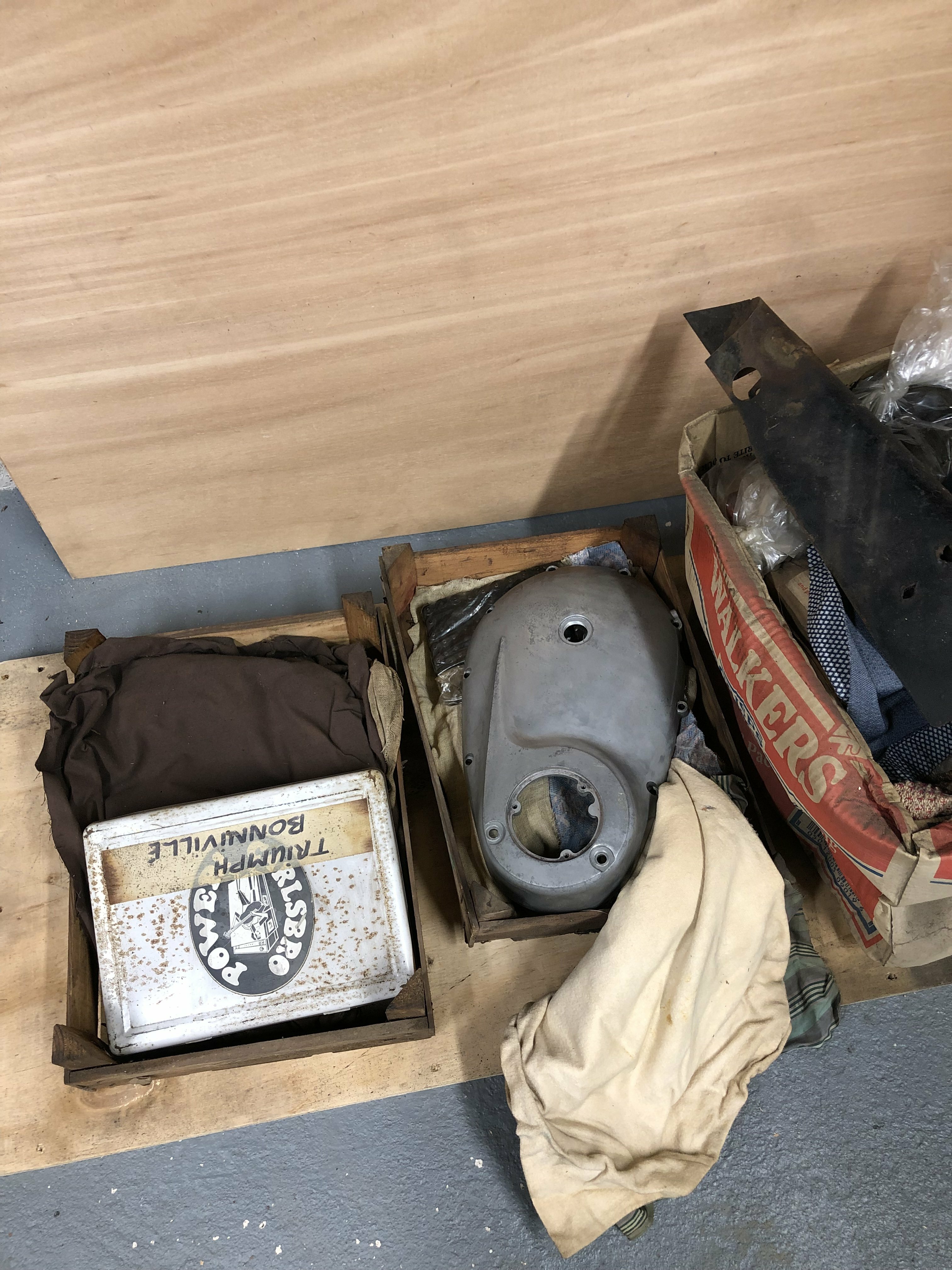

    Hi, this was my dads bike, he dismantled it to restore after having it many years but sadly passed away leaving it pieces. So I’ve decided to get it restored and get it on the road in his memory :) I have some mechanical experience as I trained as a car mechanic when I left School but this is a whole different ball game and all the guys seem pretty ok (and bonkers:p) on here and willing to help

    Ya, just a bunch of parts in boxes, just like yours.I got it at a flee market for 400.00 dollars. Unlike you I had no information about the history of the bike...it was a leap of faith. I was looking for a winter project and hadn't done anything like a rebuild before. It was the first time I heard of a sludge trap and that's where my journey started. It was a interesting, challenging and rewarding process always wondering if I forgot something, or misinterpreted some directions. A lot oh anxiety the first time you turn the key and give it a kick. I'm sure your dad is smiling...

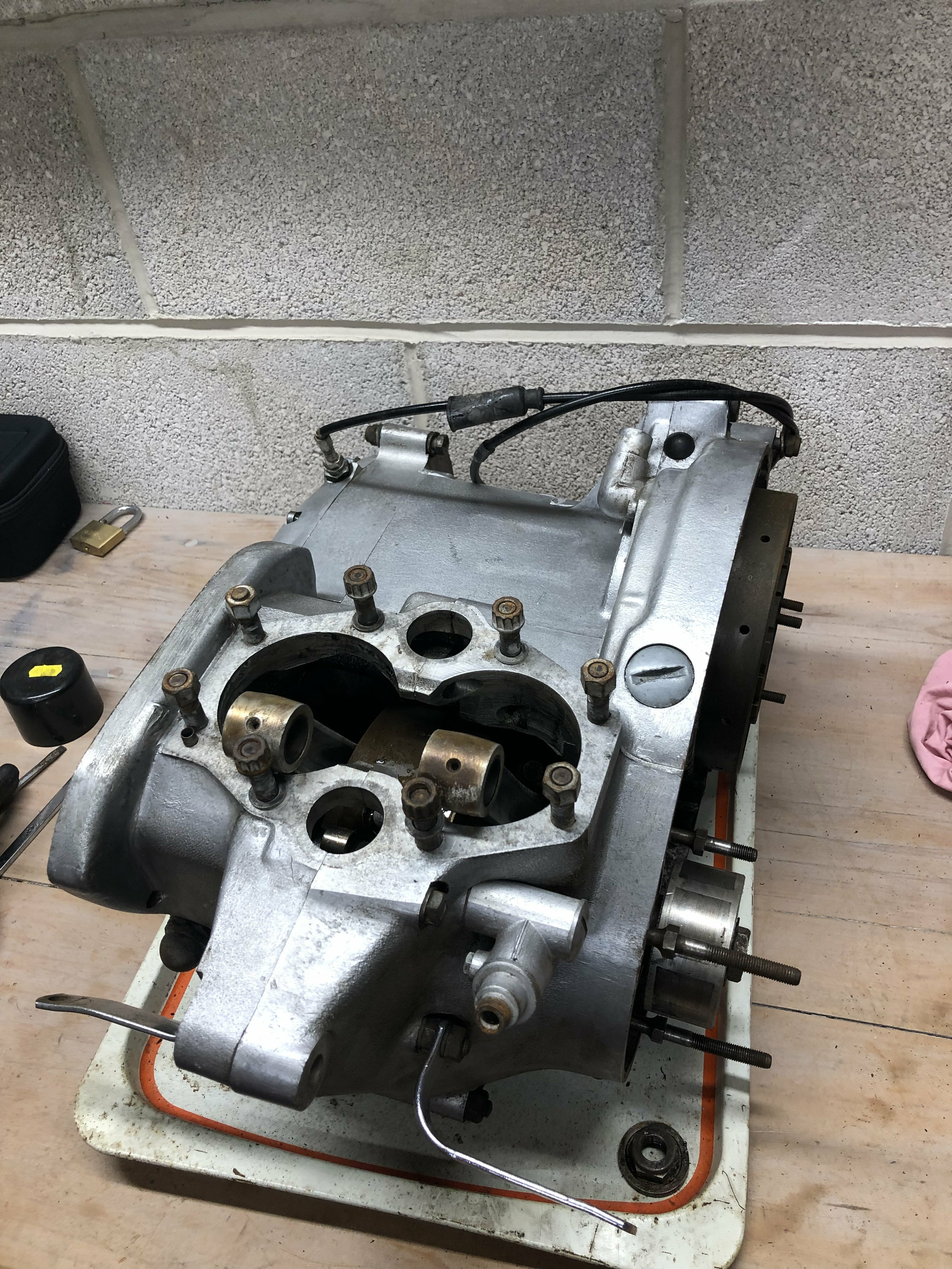

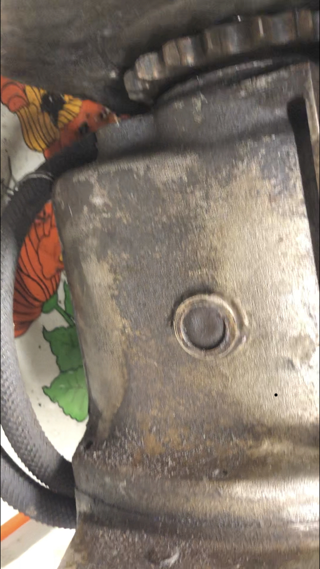

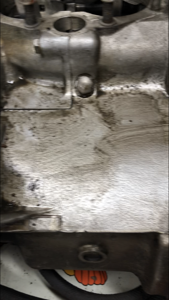

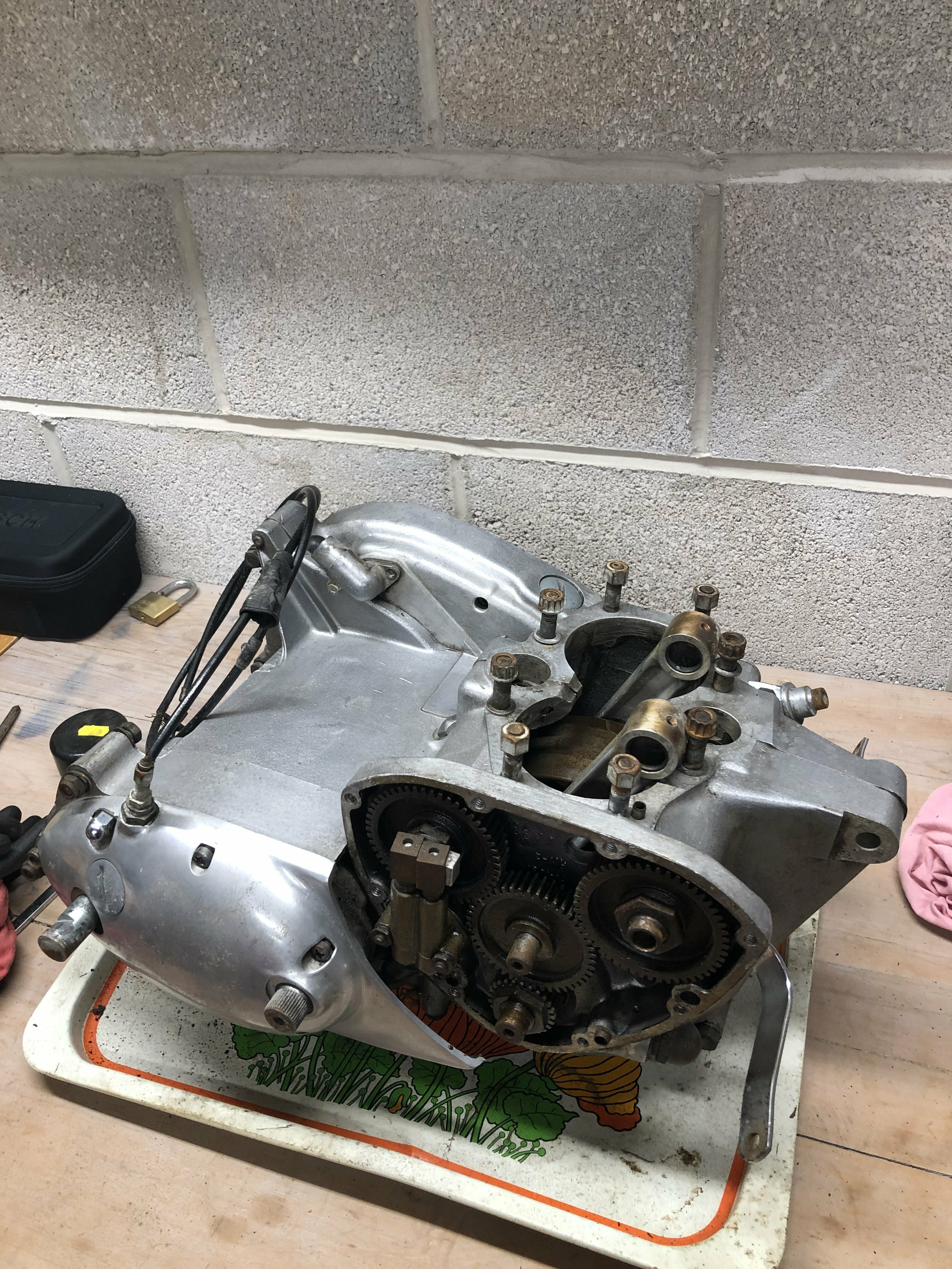

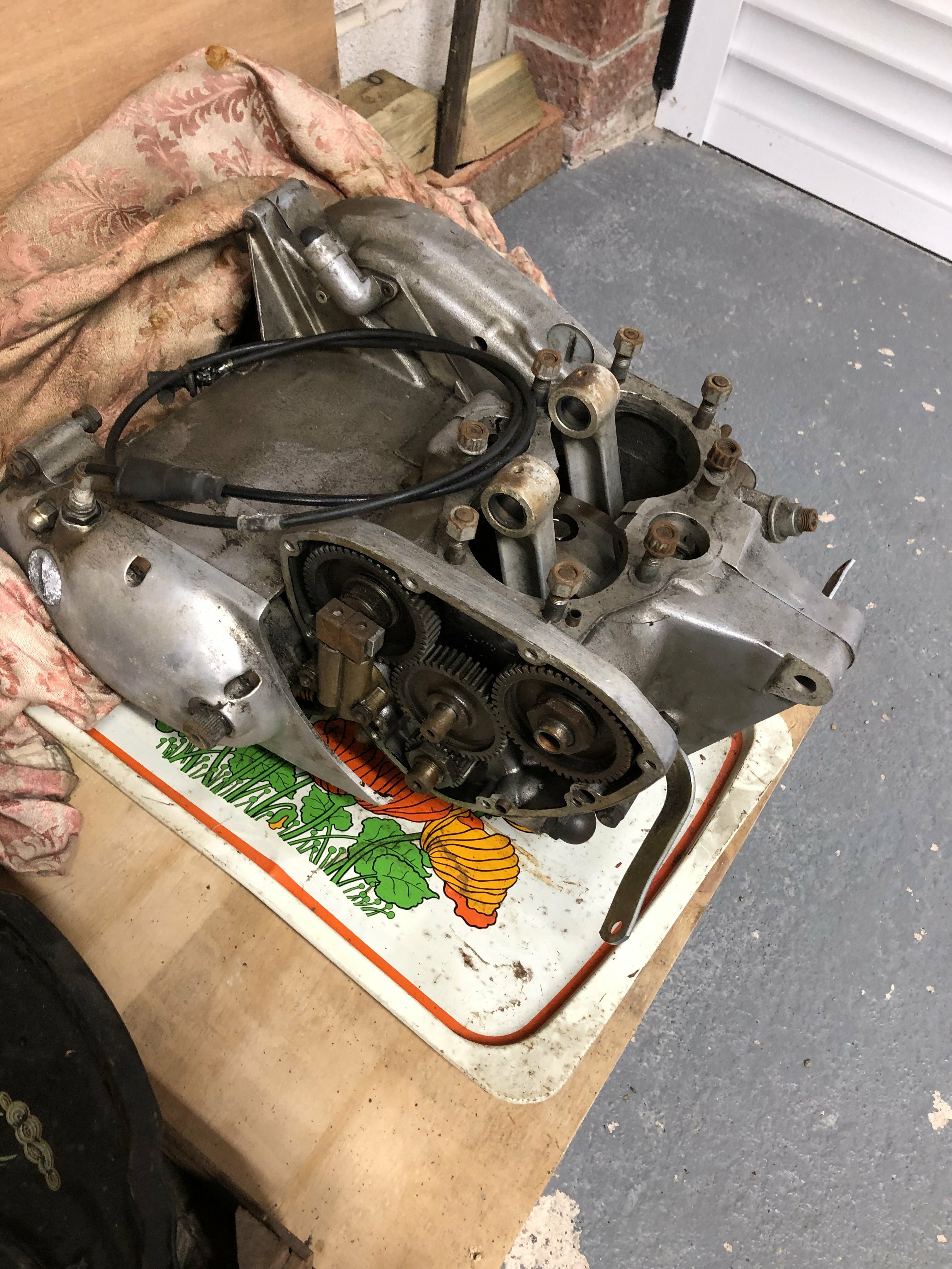

    Spent a hour or so cleaning the bottom half of engine and gearbox was going to strip it down to crank and oil tube but quickly realised metric tools don’t fit :confused: so I need to go and raid my dads shed for his tools !!!!! looking good clean though :cool:

    Are you going to split the crankcase? while you have it partly disassembled i would check the mains and big end shells and also clean the sludge trap.

    Yes that was my intention until the absence of tools stopped me :pensive: while it’s that far dismantled I might as well

    if you have access to welding kit, just weld a small bolt to the sludge trap plug and the heat will break the inevitable Loctite bond and make removing it far easier. unless it has been out before and has been replaced with a hex plug type in which case you only need the heat.
