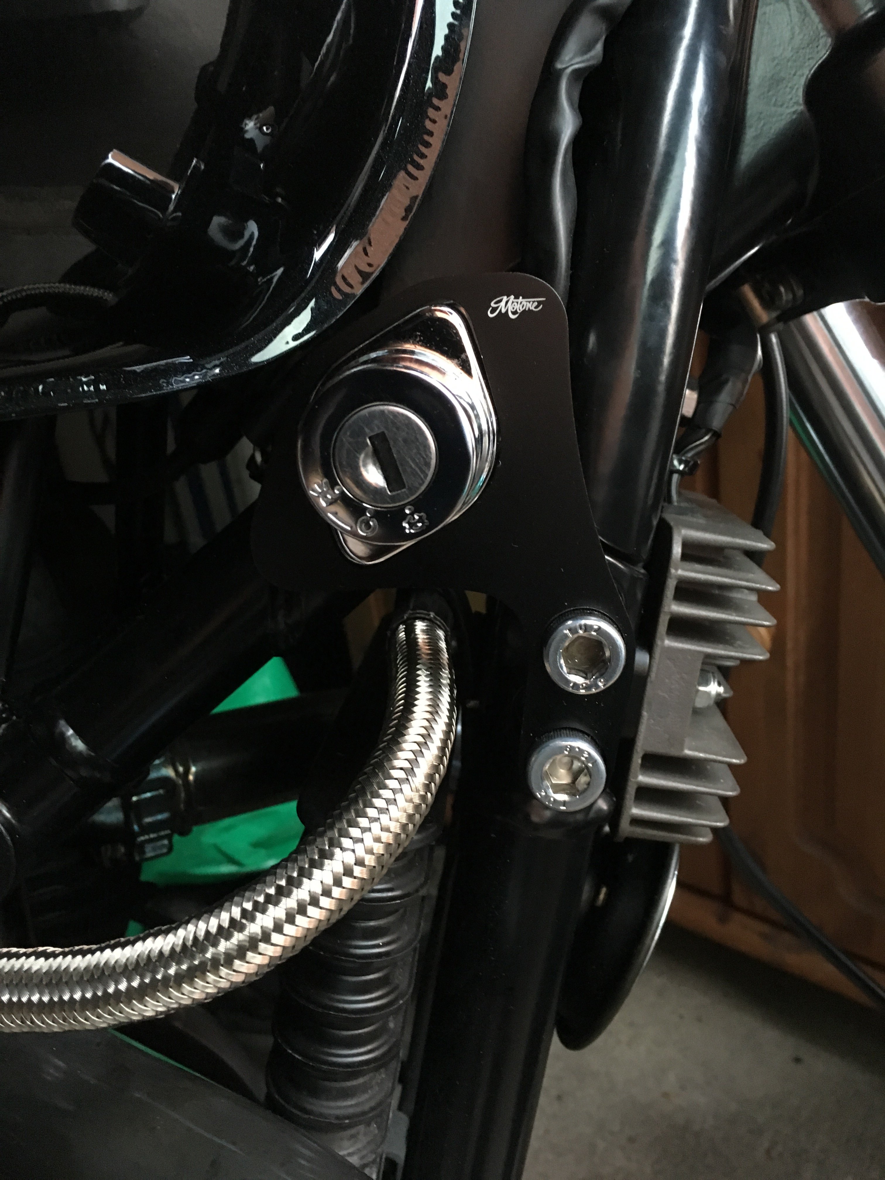

    I did this mod earlier on my 2010 se easy enough to carry out and no cutting into the loom bracket inc all bolts and spacers from Evilbay Motone just thought I'd share this if anybody else fancies swapping the switch from the left of the headlamp

    Nice one! Delboy's Garage on youtube did a good step by step video

    Excellent step by step video I basically followed this I'm sure this has been done before or posted on the site was so pleased with the outcome thought I'd share

    Just curious, what's behind the thinking in swapping it from one side to the other ?
  5. Rich Bryce
    2,987
    It improves the aesthetics when relocated and tucked away on the frame. As standard it spoils the lines around the headlamp cluster. At least that's why I did mine.

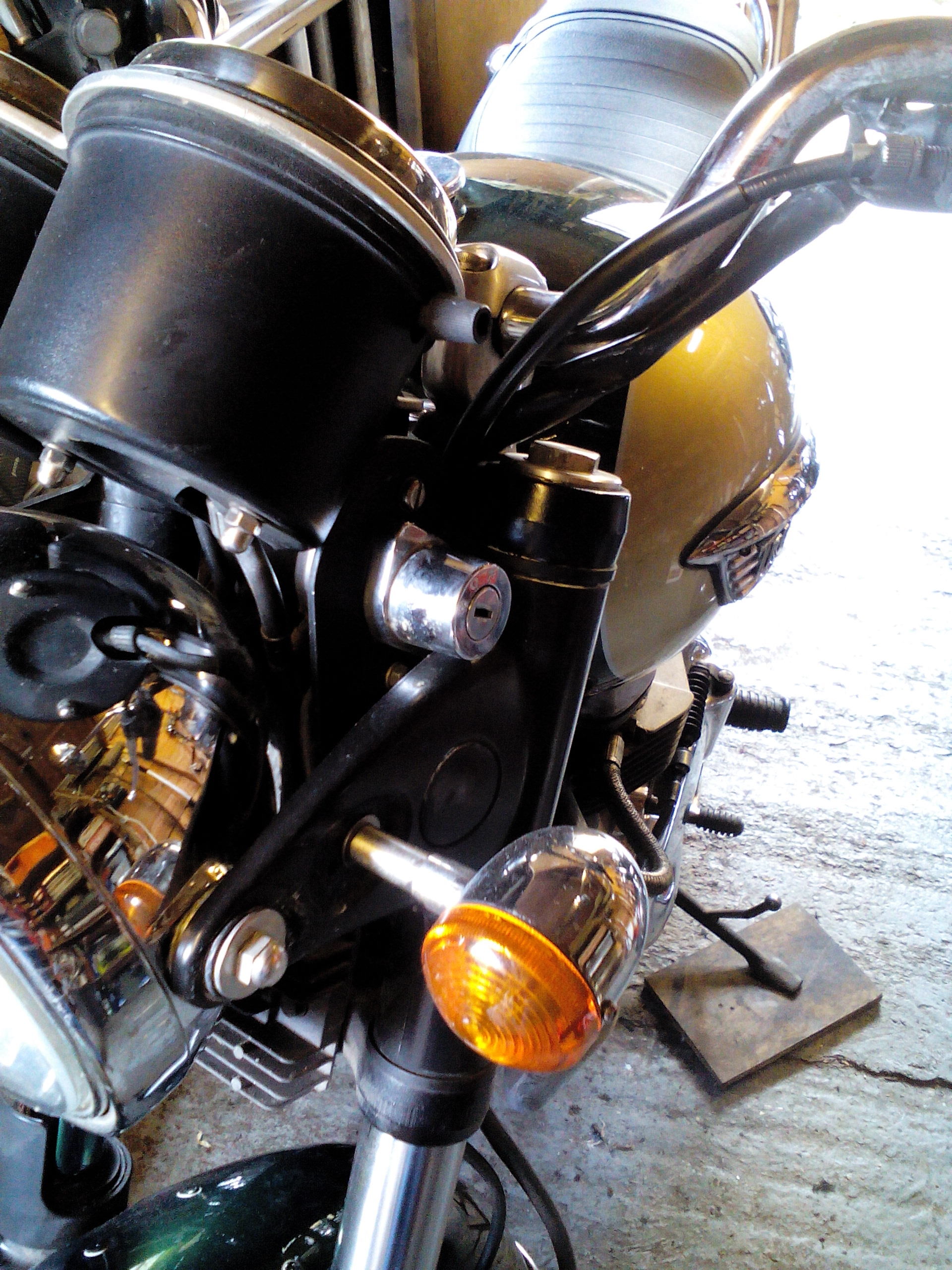

    Hello,
    This is how I moved mine, when I fitted shorter indicators it made it difficult to get the key in the hole so I made up an ally bracket and sprayed it black, then found a blanking grommet for the redundant hole. It is a lot easier to use being slightly higher up. Hopefully have added some photos.
