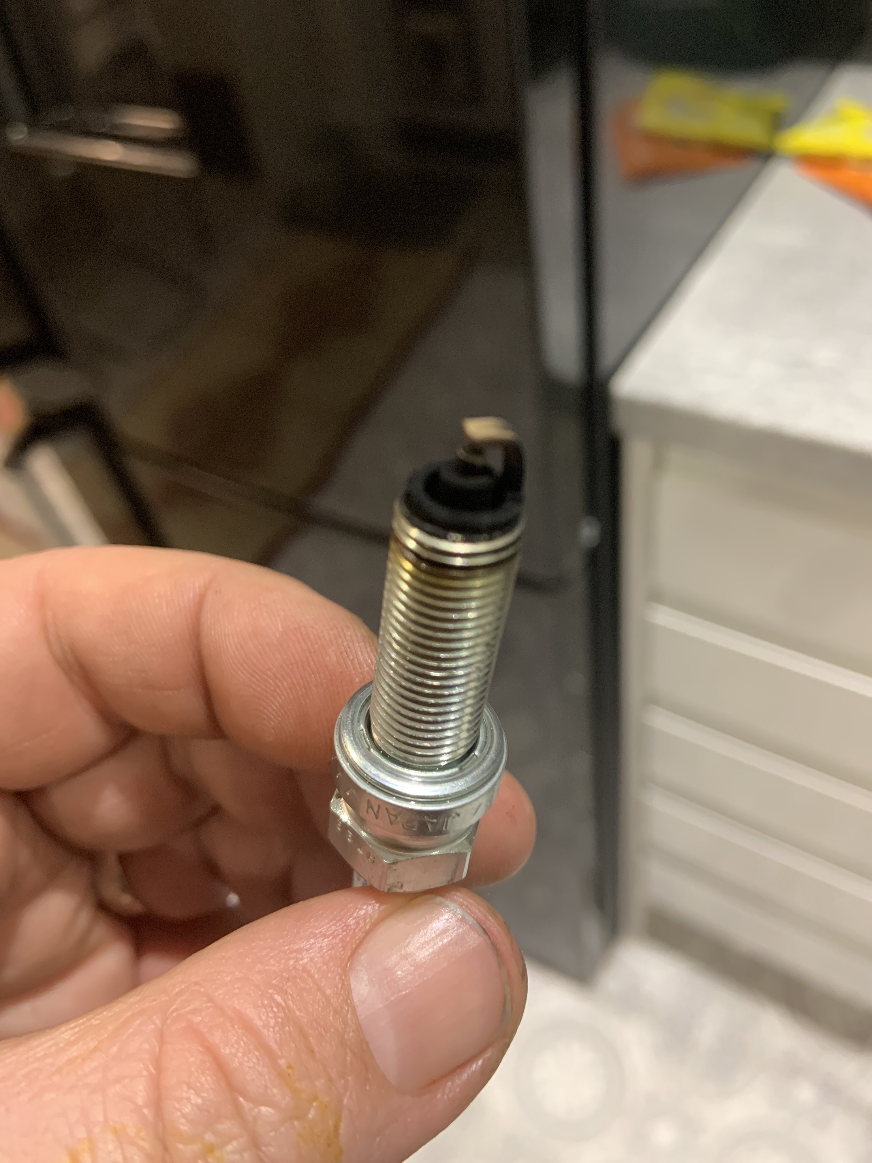

  13. Ukcjones
    Ukcjones New Member
    Feb 23, 2020
    6
    Hello again all,
    Another update ....took the plugs out today and they look really black and sooty tried new ones still a bit rough but will run ...this would maybe suggest over fuelling?
    Again any suggestions would be great it’s as I said a 2017 model with around 2.5k miles.
    thanks guys
  14. Ukcjones
    Ukcjones New Member
    Feb 23, 2020
    6
    Hi thanks here a pic....no not sure on plug chop...
