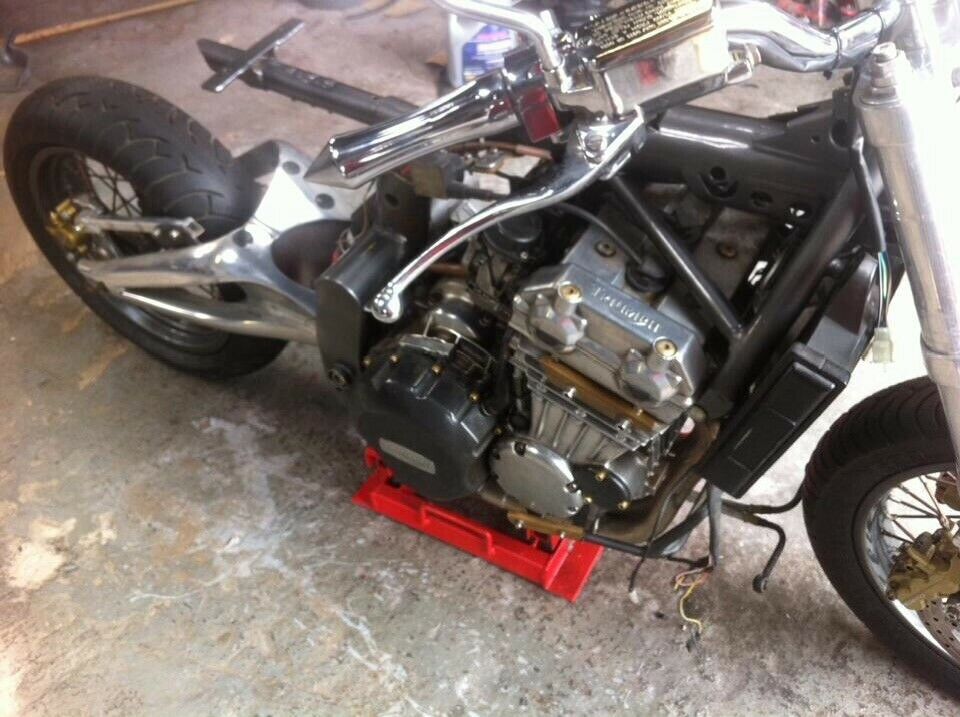

    I found this on google . You might have to type this in at https://
    vimeo.com/104415760
    Looks like it was built properly once

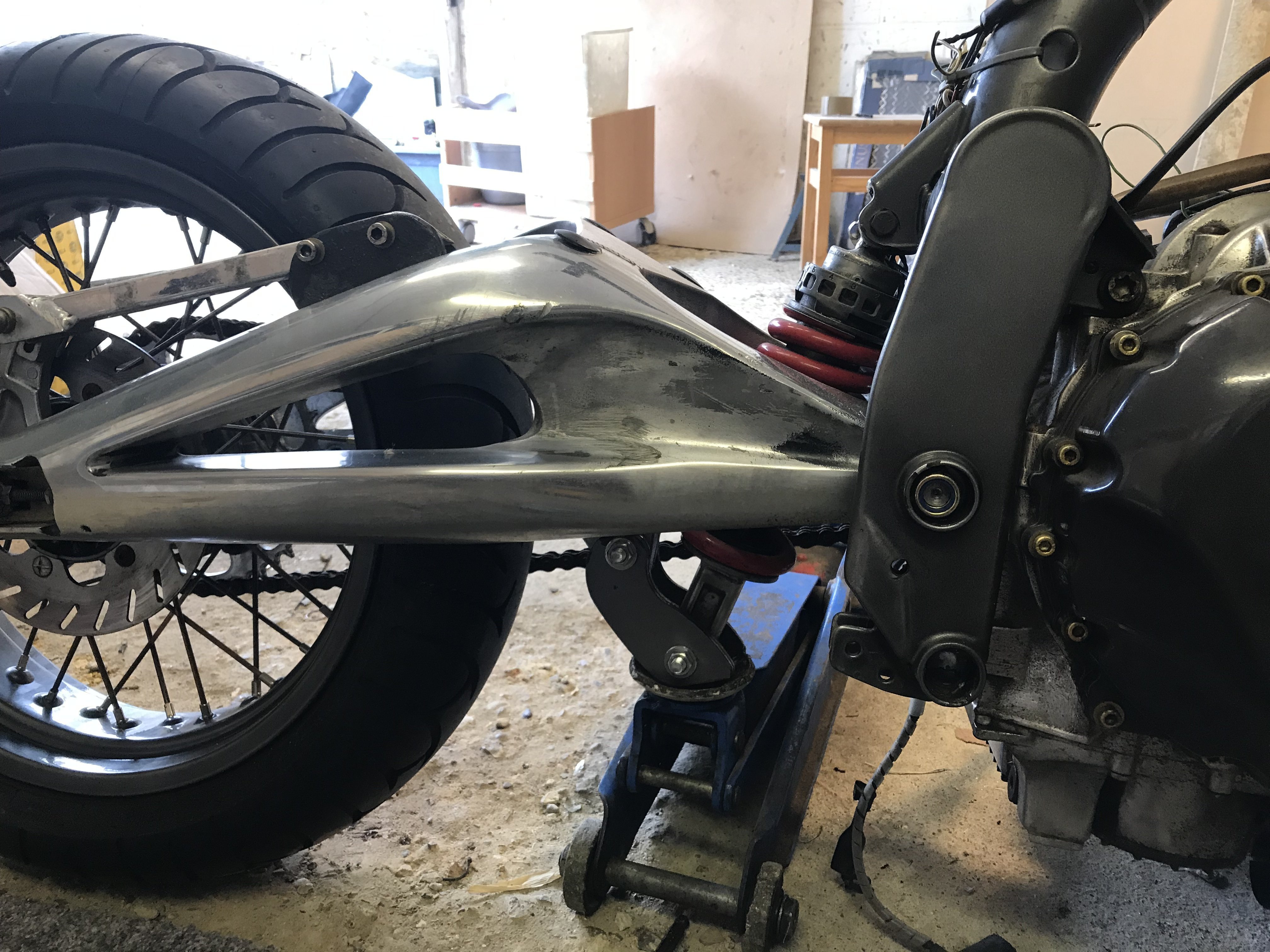

    Built back in 2014 by Hackshack Customs. But I am slightly concerned by some of the build as you can see by the lower link, also Swingarm pivot bolt is to small and has a lot of play in it

    D880F422-DAEB-402F-9E30-8F219C2EA083.jpeg So bike is stripped down
    Wiring is shot, so ordered another loom
    Front wheel spaders are not correct snd mostly a bunch of washers
    Headset bearings are the wrong size and rattle about

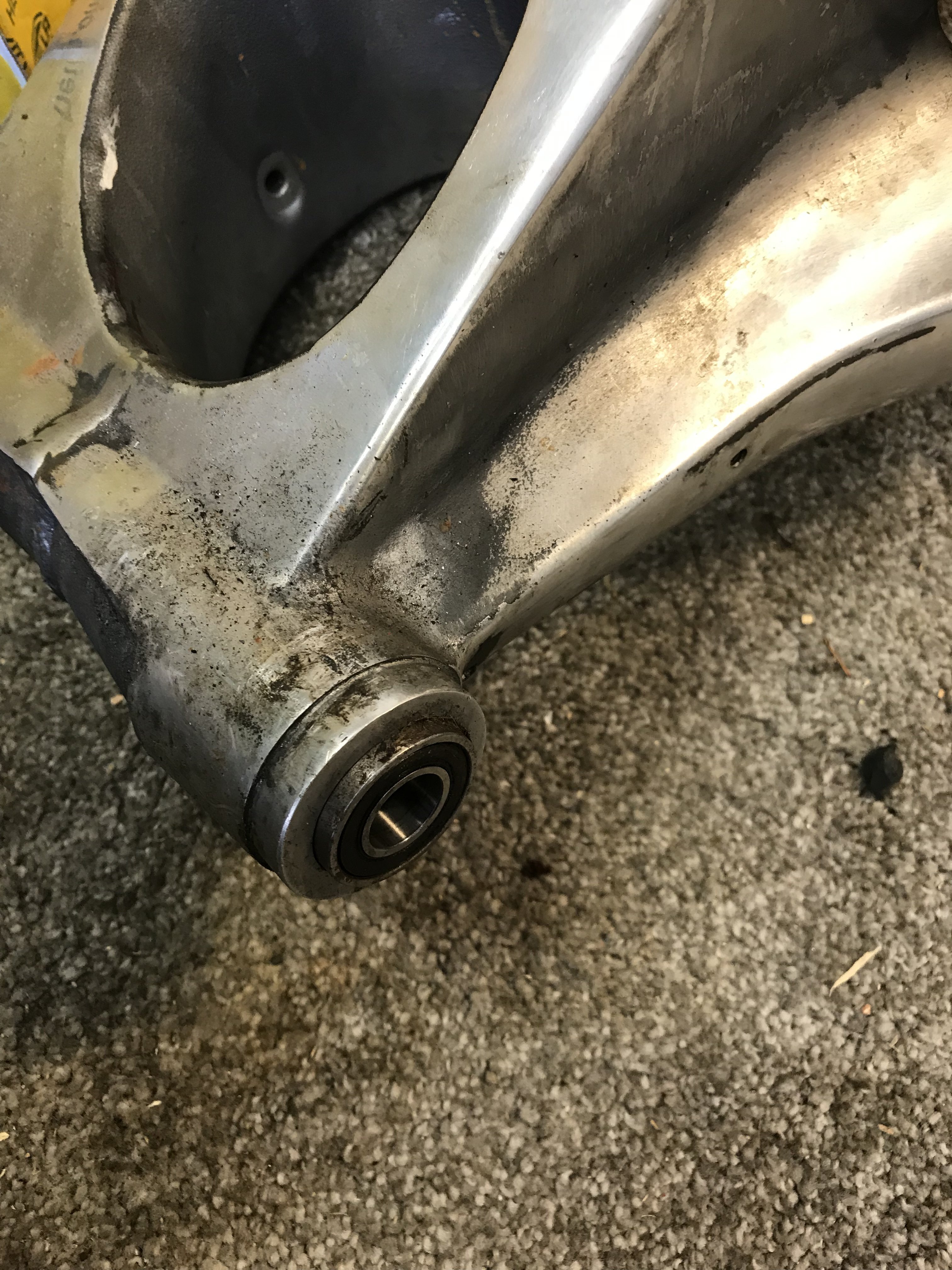

    Swing Arm had 2 threads in bolt and tightening it more would of not helped as the spacers in the arm had been removed and just a single bearing on each side
    The list goes on......
    What the lower link should look like and my link

    I got hold of another street triple swngarm for £20. So i am stripping it for parts

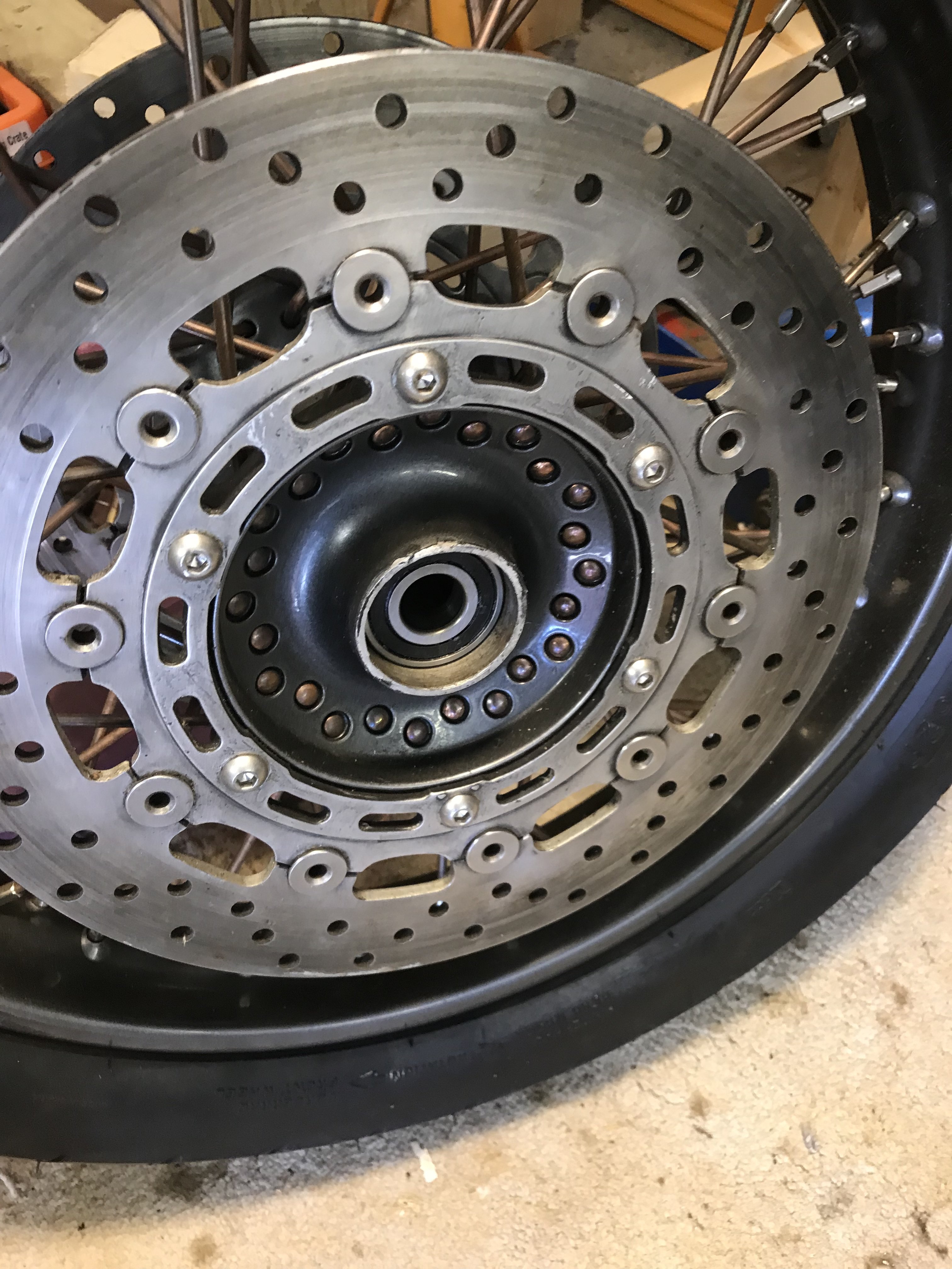

    As the swingarm spacers were removed i have gone over the wheels and they also had the spacers removed, even the one between cush drive and wheel
    Really dangerous build we had here.
    Why and what for i have no idea
    More spacers to get made bow then

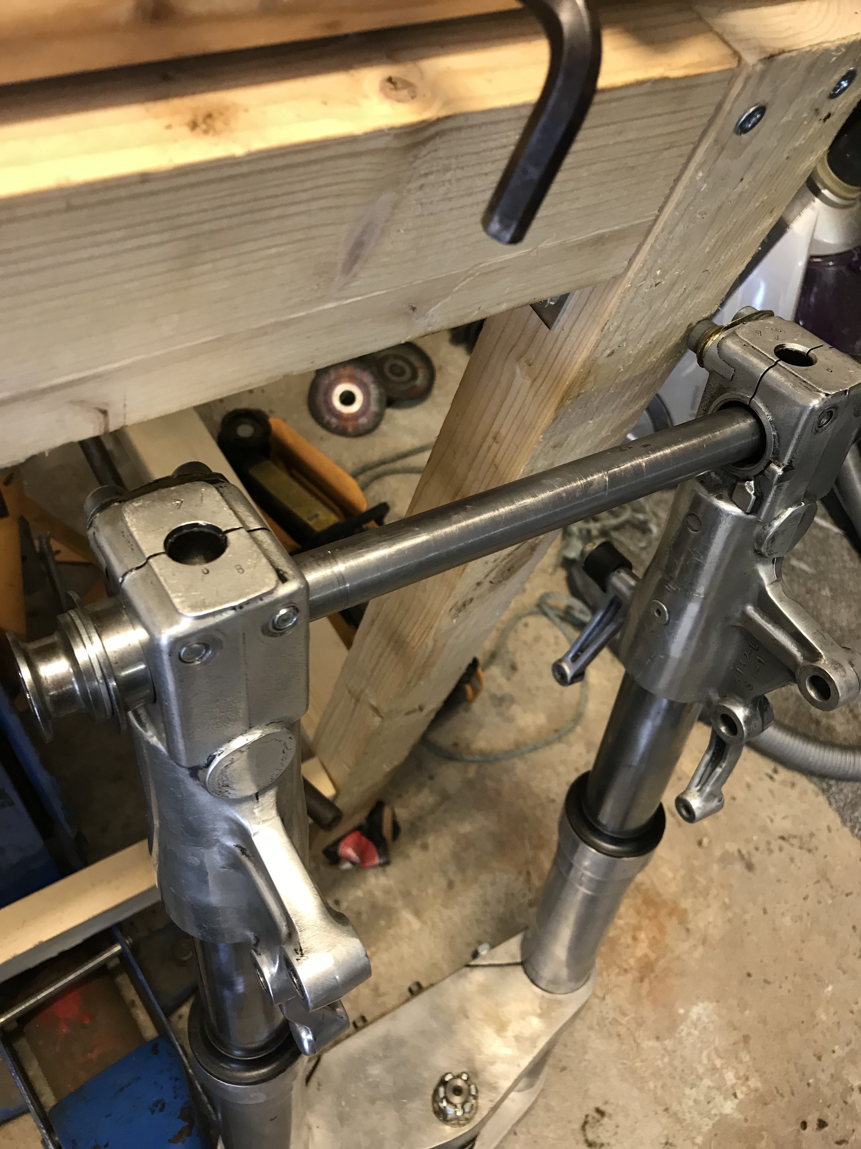

    Also header has custom billet yolks and doesn't use standard size bottom taper bearing, so some idiot has just rested the smaller taper housing inside the old one! WTF
    Yes anothe bush to be made here lol

    Front and rear wheels now rebuilt, no Idea on the make, but hey came off a Supermoto with twin disc front wheel and single disc and cush drive on the rear.
    Again, none had any spacers or seals, but they do now :).
    One of the rear wheel bearings was only held in by the pain on the rim.
    Some people should not build bikes, let alone call themselves "Custom" bike builders.
    Swingarm is also rebuilt and I have welded the frame to take the bottom link. Just need to decide on rear shock now and relocate shock top mount.

    Now I have to line the wheels up on the centre line and have proper spacers made for Front forks and rear (not a pile of washers this time)
  18. Sprinter
    6,029
    Cut some of the washers at 12 o clock and 3 oclock then you can place and replace while the wheels are in, to gauge the depth of the spacers required.
