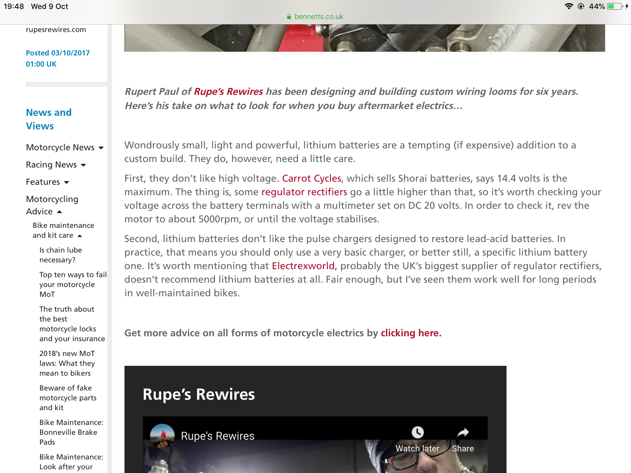

    9024F7AE-36D3-4FD6-9392-3E2E8E00663C.png Might be worth looking more into this.
    Ken.
  10. Eldon
    Eldon Elite Member
    6,156
    Interesting points about lithium.
    I am quite a technical and cynical person so the fact that they offer so much especially the weight saving is great but what's the downside?
    A few less pork pies on my behalf would give me the same weight saving and at a significantly reduced cost :p
