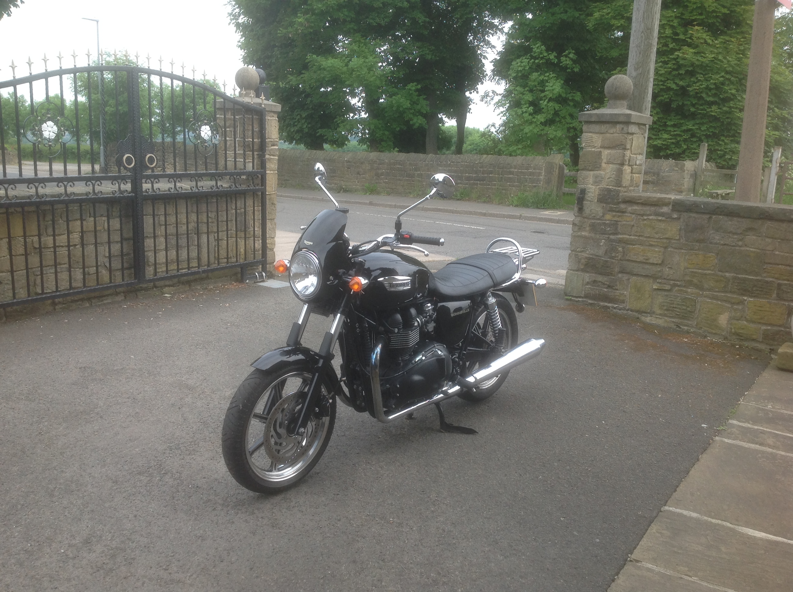

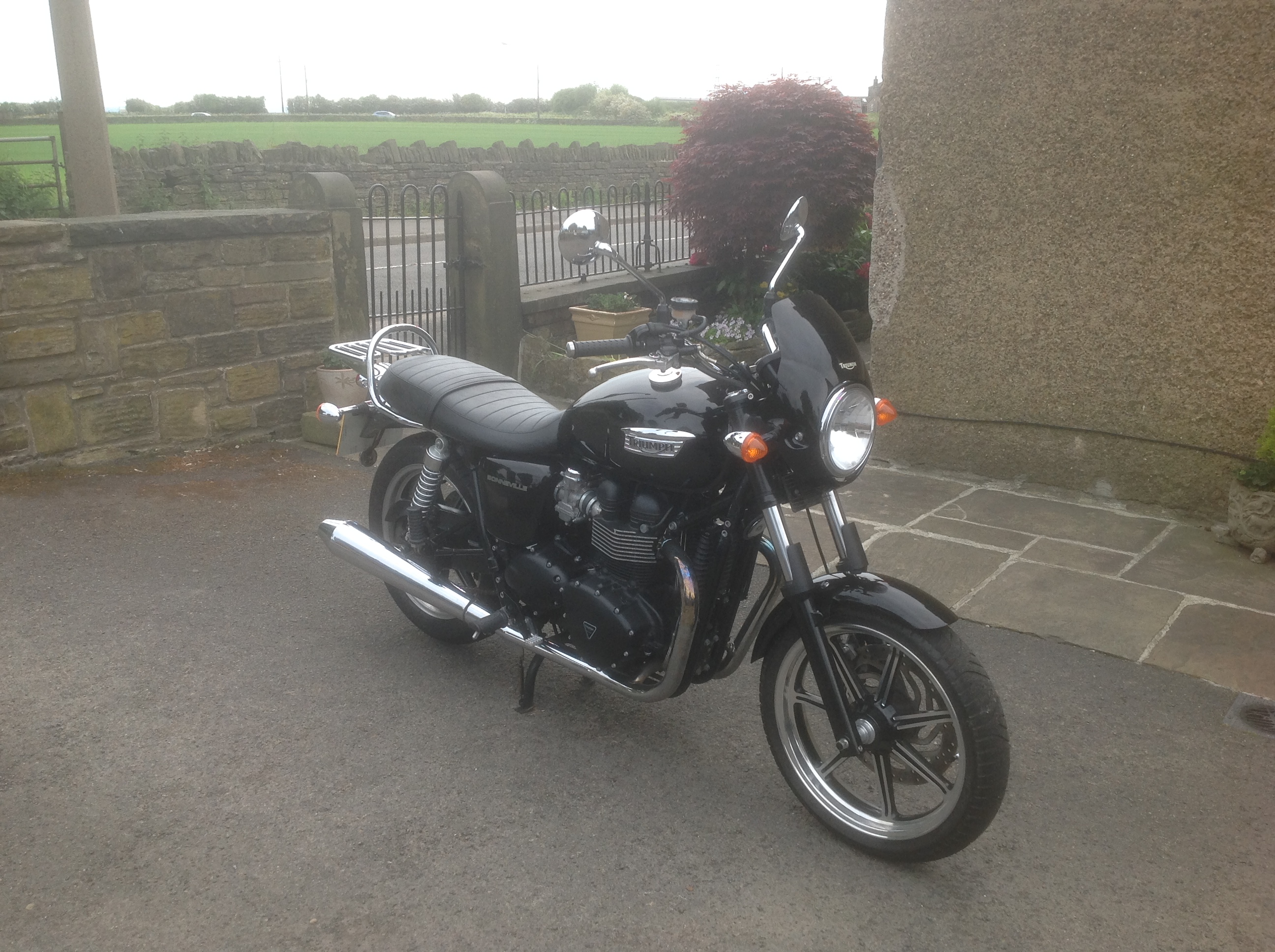

    Pics. before adding the Scottoiler and changing the rear shocks.
    3 years old when I bought it with 2k miles on the clock and in immaculate condition.
    The bonnie is now used virtually everyday and has cut my journey time to work by half. (Car used in really bad weather sorry to say)
    I previously had a Triumph Daytona (500 twin) amongst many other bikes back in the day, but I am delighted with this beautiful machine proving itself to date on rides out in the Yorkshire Dales and Derbyshire Peak District.
