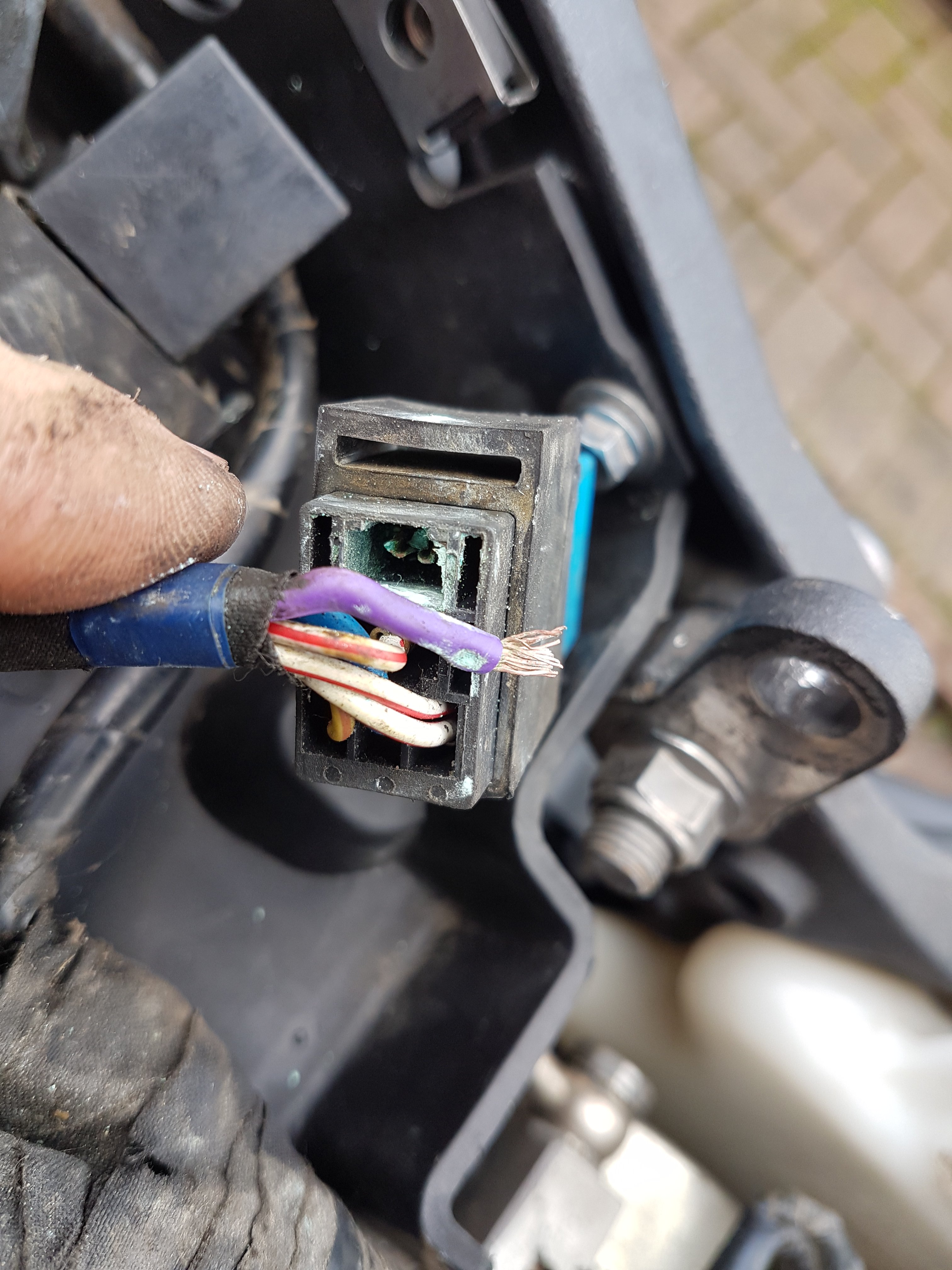

    P1685 Main Relay Circuit Malifunction came up....hmmm same one I had to resolder the wire on a couple of months ago
    Lifted the relays up and the same wire had broken (kind of, you'll read why in a minute) off, lots of green sludge around the bottom of the relay connector block and in the pin
    Then I noticed the little swimming pool under where the relays sit....
    Root of the problem, where the little plastic cable cover above the rear wheel slots into the undertray, it leaves 3 lovely little gaps for all the water off the rear wheel go under the seat, run down to where the ECU sits and pool on the LH side under the relays when its on the side stand, water and electric did a good job of eating through the wire
    Water cleared, wire resoldered, fault cleared, bike started....
    And some weatherproof sealant applied in the undertray where the the little tabs slide in......

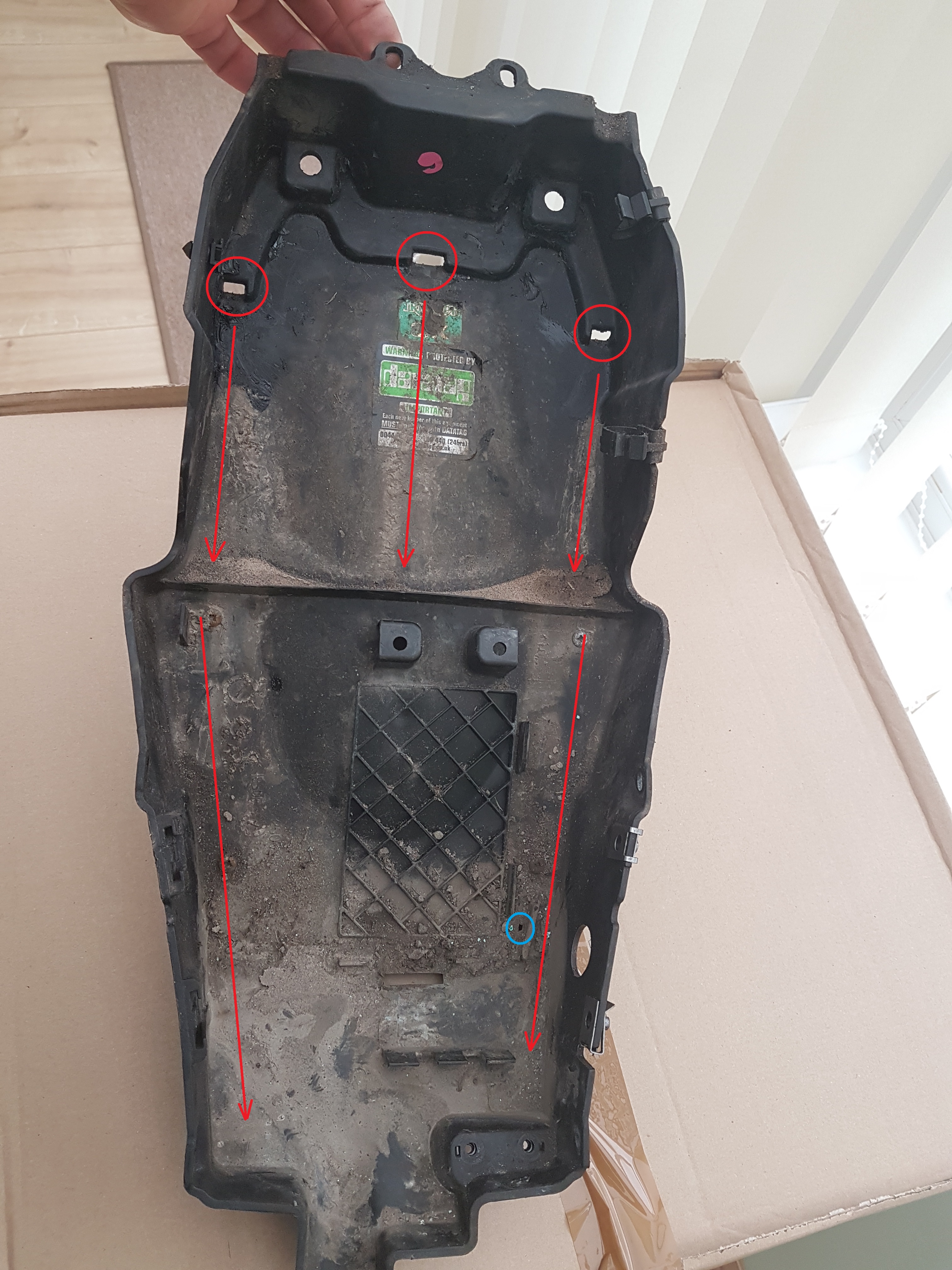

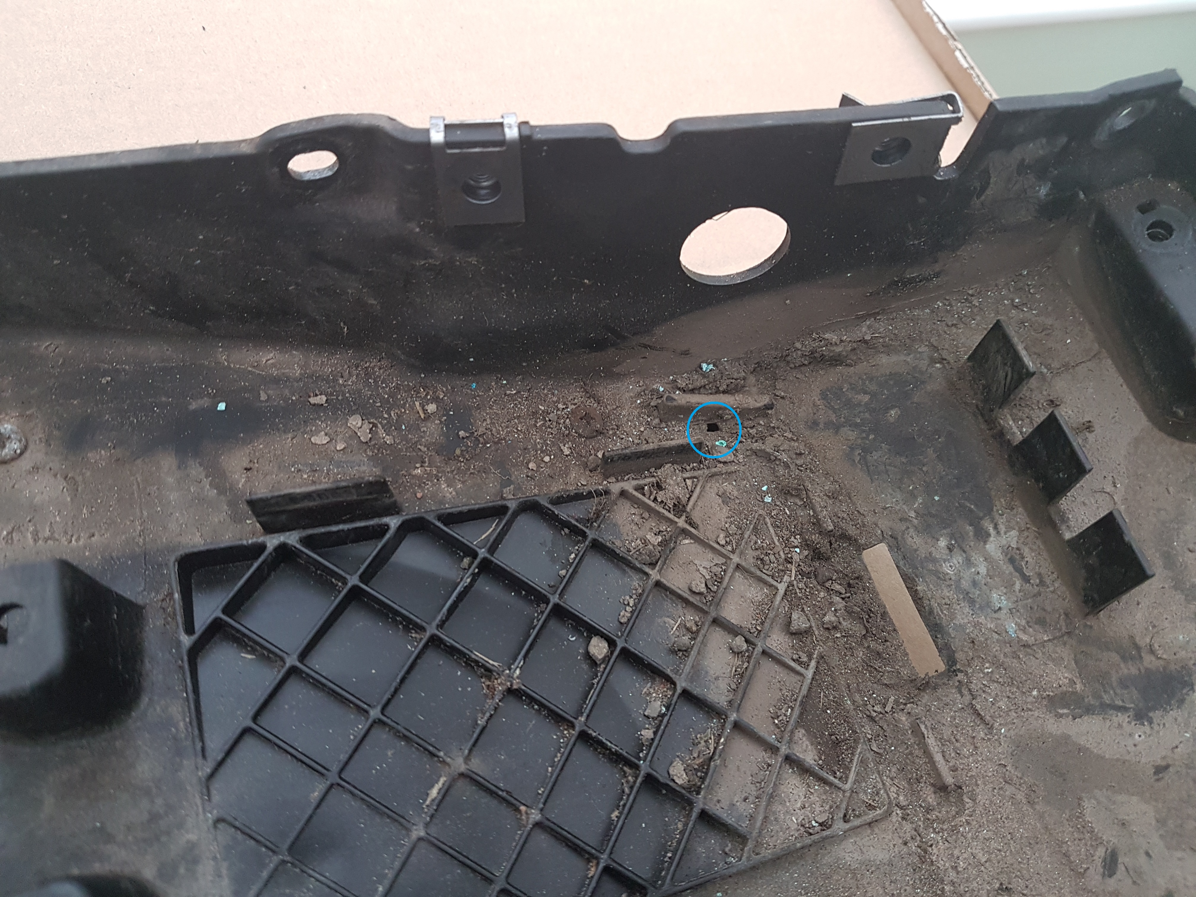

    My under tray before cleaning, its a bit cleaner around the slot holes as I removed the sealant to clean it and I will apply some more once refitted.
    As you can see the water comes in where I have circled in red and heads straight for the ECU/Relays, but hits a raised lip, on mine this was leveled with sand/grit and gave free rein for the water to go where it wants.
    I get a bit of water come through the round holes too so I shall fill those as well.
    There is a drain hole where I have circled in Blue but mine was blocked. (The rectangular slot at the bottom is filled with the ECU retaining strap)

    You can see where the spray off the tyre goes directly onto the slots/holes.....

    I found 2 more drain holes in the upper part where all the sand/grit collected...
    Nice to know that they knew the water would get in but thought 2 drain holes was easier than fixing it....

    And the hits keep on coming.....
    Building bike back up with cleaner undertray......spotted another wire hanging out of a different relay....
    Fire up the soldering iron..
