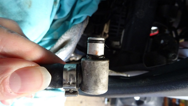

    Hello,
    I've disassembled my 2004 Daytona 600 during my white smoke investigation (see other thread) and would like to fit new o-rings to the fuel connectors as I have one missing and another in an iffy condition.
    I know some time ago there was a recall or something with fuel connectors being replaced for metal ones?
    However as I am investigating my Daytona's white smoke issue I don't want to be spending on parts if I am soon to have some engine bad news :sob:
    But I would prefer not to go up in flames when it's reassembled and fired up :sun: (just imagine a flame emojii)
    So new o-rings is what I require. I recall looking at parts diagrams recently but don't remember seeing the o-ring as a separate part.
    These 2 connectors; (a metal & plastic one - the ones on this connector look smaller)
    If anyone knows the correct size specification and/or a supplier (I'm in the UK) of replacement o-rings that would be much appreciated.
    EDIT: I could remove and measure them but o-rings 'deform' over time and it's the original size you need to know. Also they might not play ball and come off neatly.
    Thanks,
    Mark

    The metal fittings come from https://www.cpcworldwide.com/ and at least the USA distributor is http://www.quickcouplings.net/. I am also researching the o-ring part number. The fittings are LCD10004BSPT (1/4" female fitting on tank) LCD23004 mating fitting. These are for the return line. The pressure line is 3/8 inch. My Sprint RS has barbed fitting on tank and a right angle fitting, however my Speed Triple has both females fitted to tank. The 3/8 fittings are LCD17004 and LCD23006. Look at the images to be sure. I figure the 3/8 female in the tank is LCD10006BSPT. I will be contacting these fellows and will find out what the O-Rings are. I just bought a few of these. I am also using Viton rings, as they are better than buna-n.

    The standard size used for the older fittings are T1240181 Triumph part. This is a 5/16" ID, 7/16" OD, 1/16 Width, Buna-n, Hard 70, Shore A. Fastenal part SKU1166805, or McMaster Carr 9452K19 - 011. Viton is 9464K16 - 011.

    Yes - I ended up taking off one of the O-rings I was replacing extremely carefully then measuring with a calliper.
    I contacted ebay seller SealsRus who got some in the size I required.
    See the seller HERE
    I'll try and find my measurements next time I'm in the garage.
