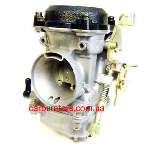

    Your low tech solution is to ease the carbs off the inlet manifold and back blast the tiny galleries and jets with aerosol carb cleaner.
    Your target is the two oblique slots at the bottom of the photo that feed fuel from tickover through light throttle until the slide and needle lift and the main jet comes on stream......at about the point your problem disappears. Stick the aerosol fine tube right in the hole and hose them out........

    The ones down a hole?
    Would it be better to fit new ones
    If so where can I get them
    Cheers all
    cheers for photo
    So it’s them two holes at the bottom of the mouth
    I’ll get on it tomorrow
