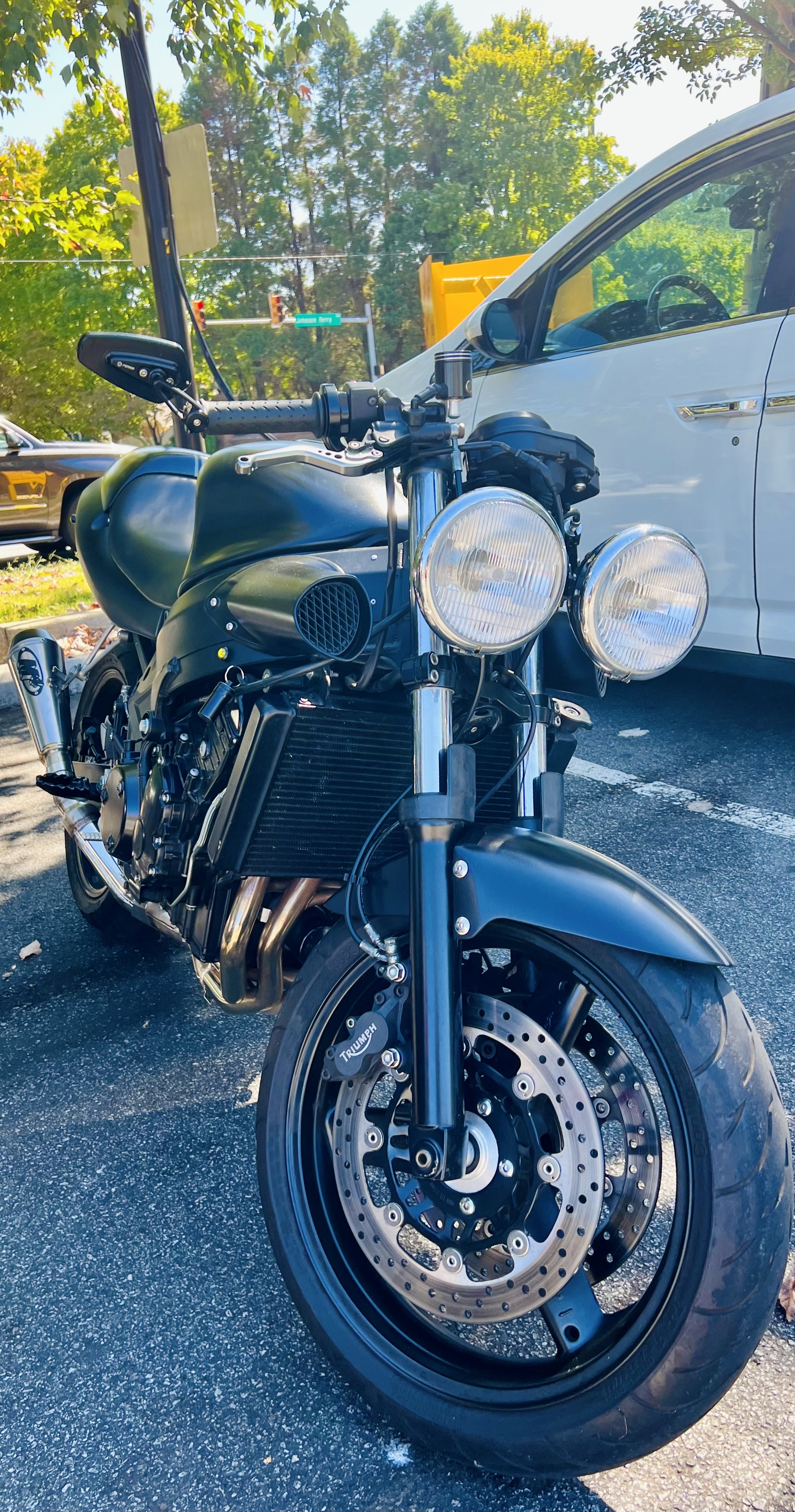

    Hey All,
    I’m about to get a 2003 Triumph Speed 4 (custom), sale pending by this Friday! I fell in live with the vintage look and customized cafe racer style, supposedly loud & fast
    Very excited and a bit nervous, not too much experience with sports bikes, this one is customized and looks like a badass IMHO :)
    It’s about 15k miles but odo reads around 3k, when the current guy (owned for 8 years) changed to new odometer he couldn’t figure out how to keep orig miles so he says! Also have not performed any valve adjustments, and no oil change since about 2020! He used to work on the bike so the bike likely has not seen a trained technician (maybe ever).
    I’m hoping some of you pros can guide me through the owning and maintaining process! I can always go to local Triumph dealer/service, but it’s not the same hearing and learning from other experienced owners..hence Im here to learn and share!!
    Thank you and meep you all posted on my purchase very soon…
    - boooya

    Quick update: I GOT THE BIKE!
    Riding almost an hour coming home after the purchase was quiet thrilling, some city roads, some highway!! Highway definitely awesome
    The guy I bought from had said it had hard time finding Neutral, which I experienced at first, he even lowered $250 from asking price but as I rode home it loosened up and improved significantly.. my guess is he hadn’t been riding much or just short distances to keep it warm the last couple of years and likely just needed that?? I may take it to a mechanic and get it checked out if the clutch wire needs a little loosening!!
