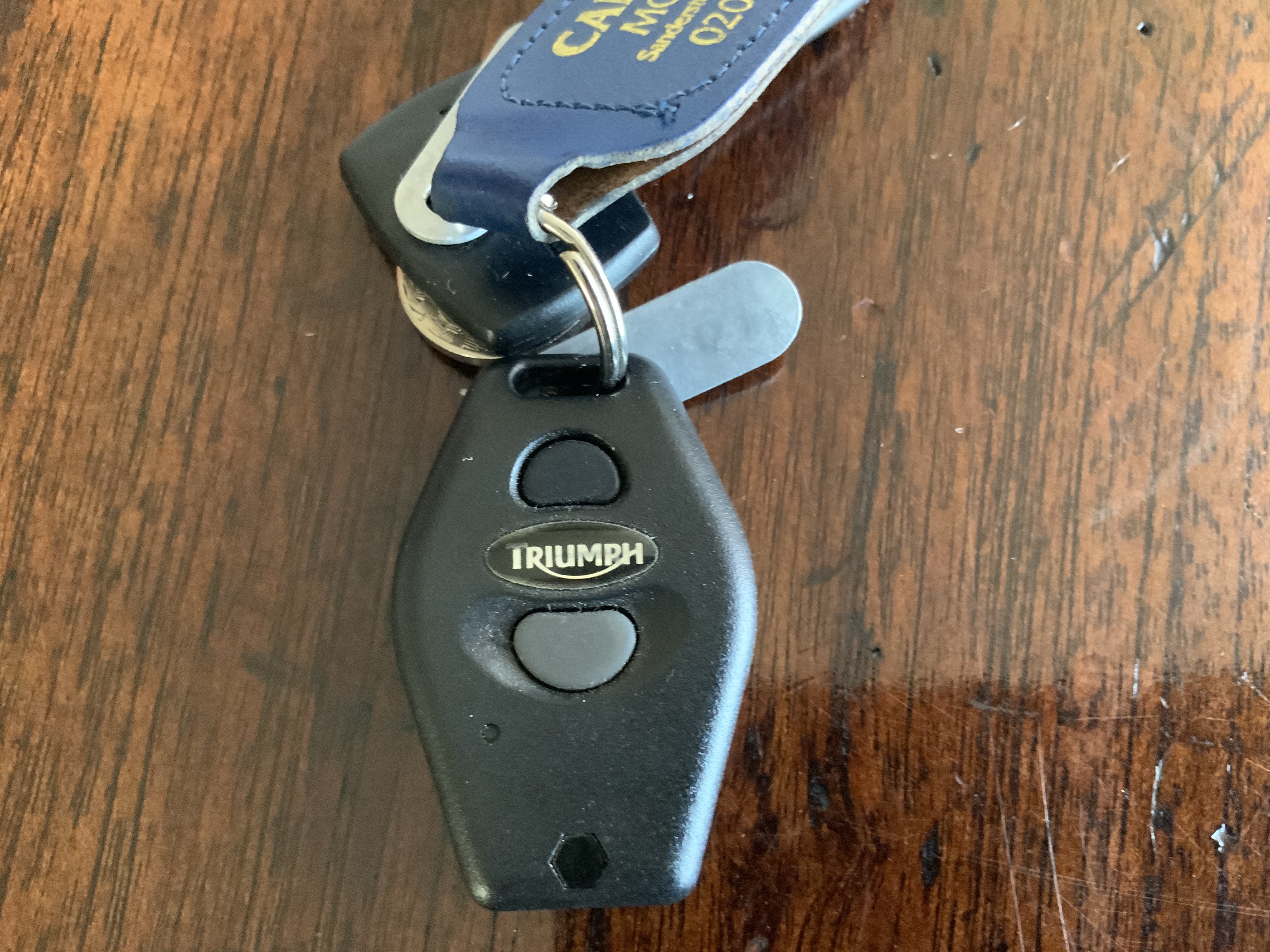

    Hi all,
    I’ve bought my Bonnie last year and can’t seem to get the hang of the fob.
    I think the grey knob is on/off, and the black one is used to stop the immobilisor from werking, but how?
    Every time i shift the bike the neighbours come running down...

    My data s4 just works on the grey button, I just let the immobiliser self arm, which it does after several seconds giving off a few beeps, when I come to use my bike I press the grey button before turning on the ignition , the indicators flash once and the red light on the clocks go off. If I want to set the alarm I press the grey button. If you want to put it into sleep mode or ferry mode the black button comes into play then.
    Edit* I think the visible and audio warnings can be set up differently but only at the workshops

  6. crispey
    7,225
    You can get a by pass plug that disables the thing for around a tenner

    Best on there as the thieves are out in style now. Its simple. press the button to set the alarm it flashes twice press the other button straight away it flashes three more times and it asleep till you press it again. You can also turn the alarm of just press the button to turn it of then turn the ignition on hold the two buttons for a couple of minutes and it turns of wit a bleep and flash. In that mode you can take the battery out or work at electrics without annoyance.
