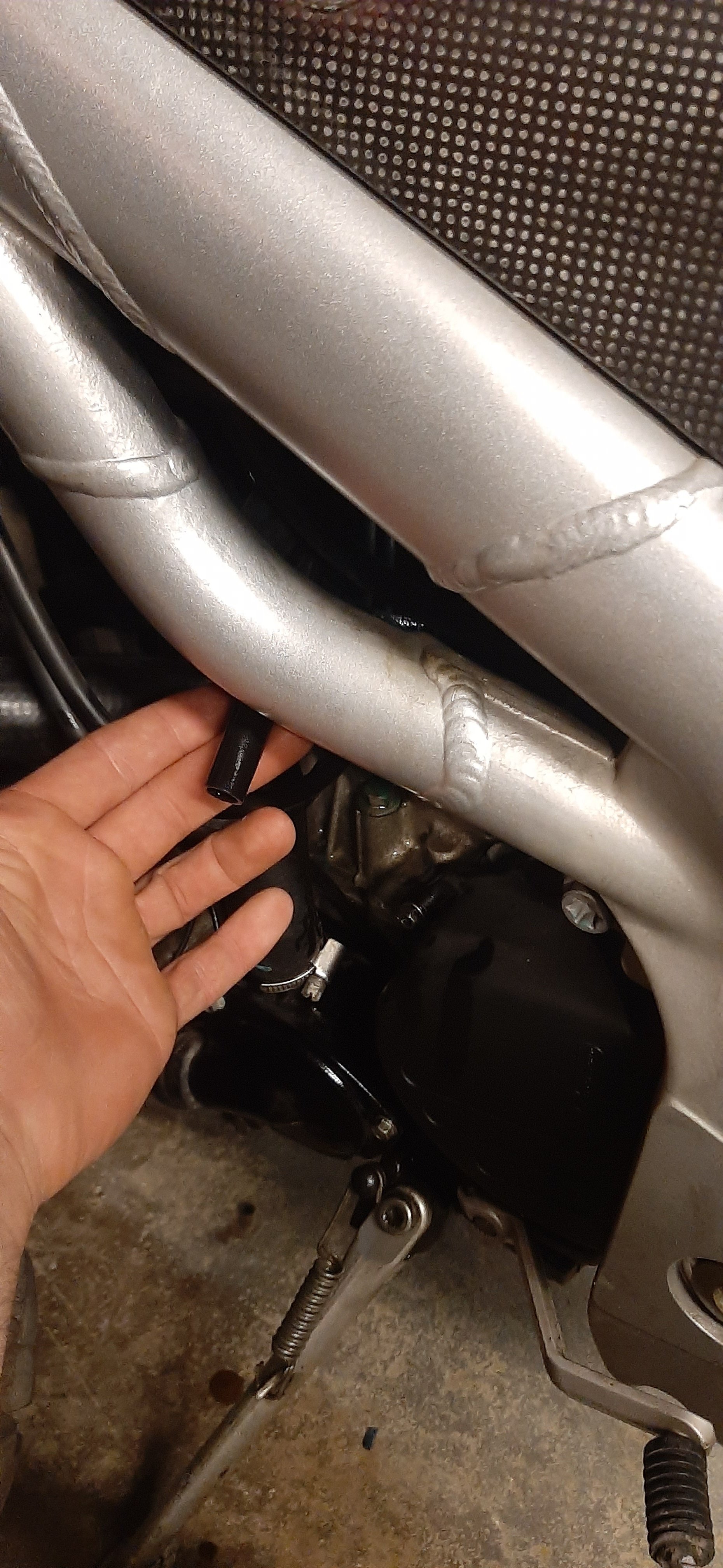

    My air box is full of oil and is dripping out of a hose like an overflow hose
  9. Sam G
    Sam G New Member
    Feb 1, 2021
    2
    Medina ohio 44256
    My airbox on my 955i is full of oil dripping out of the what looks like an overflow hose what could be my issue I might have had too much oil in it but now it's coming out real fast only when it's running here are some pics please help it won't let me post anywhere else on this page for some reason
