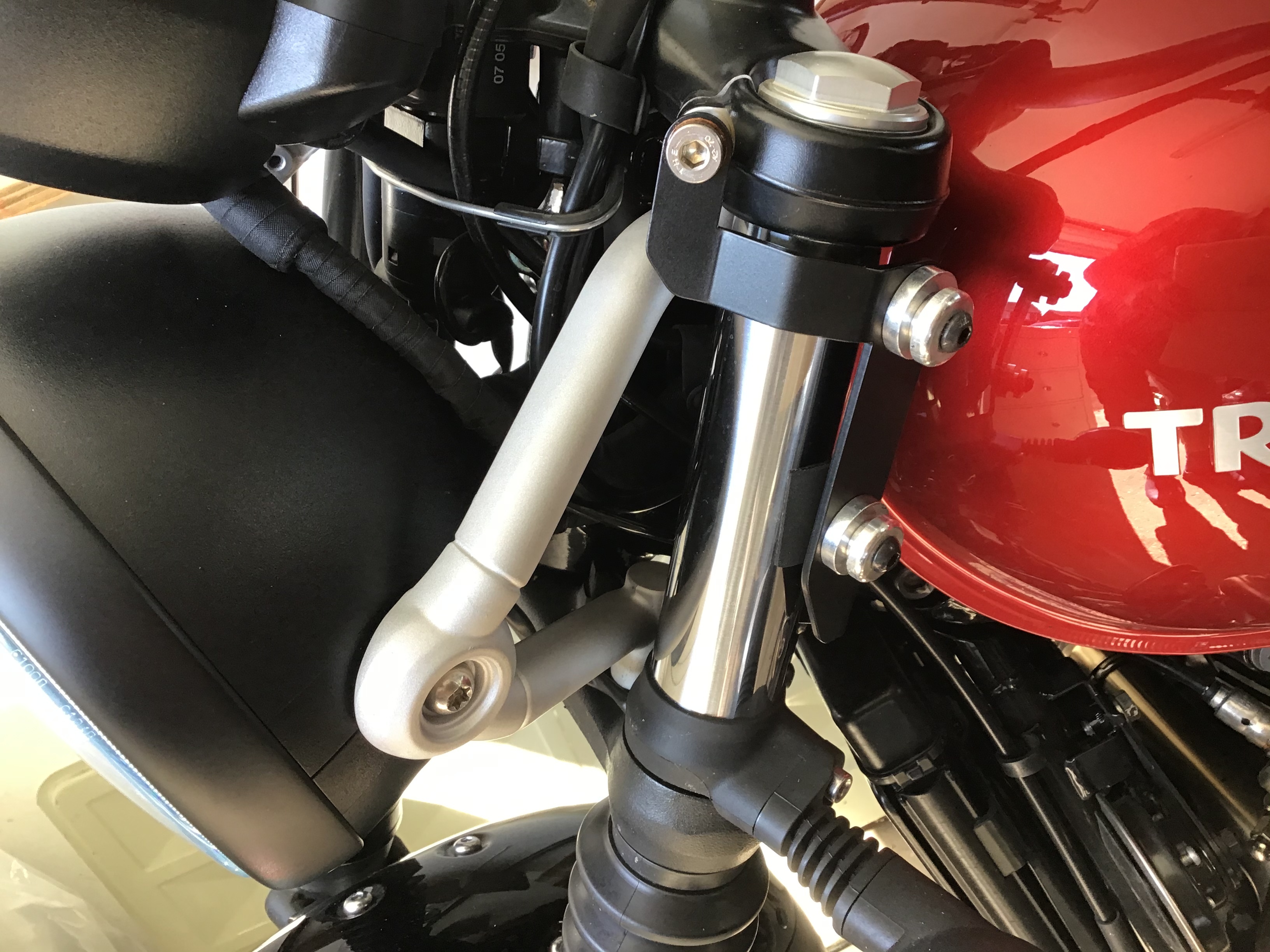

    Hi, I’ve not had opportunity to set the screen angle/height adjustments up yet as a couple of days after getting the dealership to fit the mountings the lockdown happened. .. so my poor bike is stuck in the garage as with most others... the dealership only put the fittings on and I attached the screen when I got the bike home... the quick release system works easily and I don’t think the fittings look too obtrusive with the screen off. .. pics attached ... when we get out on the road again I’ll be able to set it up properly and post my verdict.. fingers crossed it’s worth the cost as it was with the Madstads I fitted to my Tiger 800s ..for info there are some further pics on the bikehps website where I got the screen from as well as on the Madstad website .. best wishes :mask:

    those bracket do look neat and unobtrusive! please post an update when you've had a chance to test it out! I have the rugged pannier on my 1200, makes it the perfect bike for grocery shopping during the lockdown!

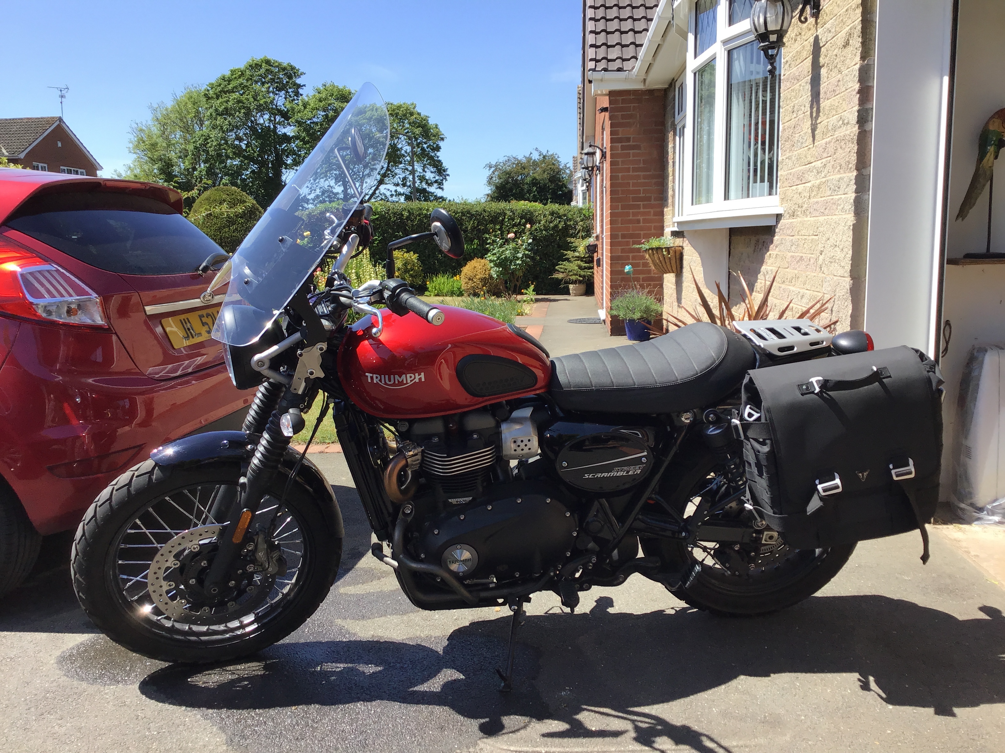

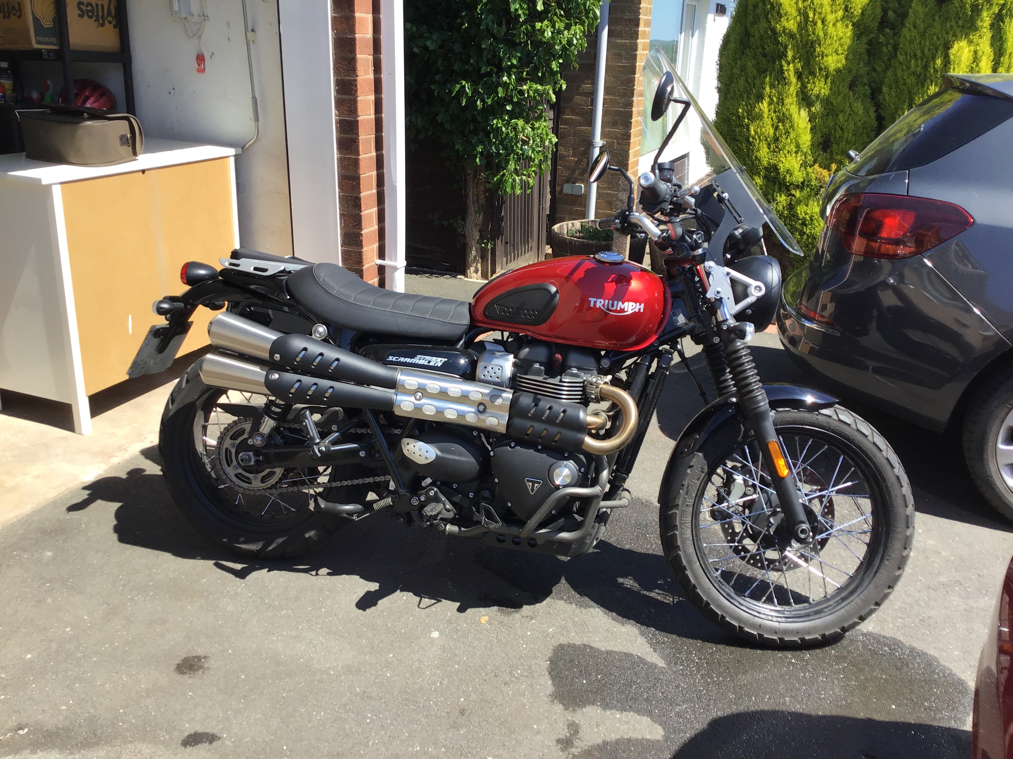

    I’ve tried the screen now and it’s a mixed bag....basically I wouldn’t rush out to buy one. At full rake back and at it’s max height it allows me to ride faster and for longer, (70 ish), in reasonable comfort but at under 50mph riding is far better without it due to wind noise and airflow issues. I can only use my Schuberth C3 Pro helmet with the screen on and have to shut the visor at over 30 mph and can’t use my open face (albeit it has a face shield), Shoei J. Cruise helmet due to excessive noise and airflow problems. At a flatter rake the wind noise is unbearable and creates buffetting and at lower heights the air flow isn’t going over the top of the helmet. I’ve done the usual sitting up , crouching down, leaning forward and back whilst riding in an attempt to find the sweet spot but it’s no better than I describe. I wonder if a larger screen would be better but the 20” is designed for my height and a bigger area of screen would increase the amount of air to be displaced so prob no better.. given its a lot of money I’m not going to splash out on a trial & error basis. Whether the screen would be better on the Scrambler I don’t know but I would think probably not... it’s a disappointment as the Madstad I fitted to my Tiger 800 was absolutely superb at any speed, visor up included... just doesn’t seem to work on essentially the design of a classic naked bike. So I’ll fit it when going a longer distance and need to be on A road motorway type speeds but for my usual pottering around the country lanes at up to 50 mph I’ll take the screen off and be able to enjoy a ride with whichever helmet I want, visors up or down. I think I’ve accepted it just isn’t possible to have the best of all worlds with one bike ... luckily it’s a quick release screen so on and off in under a minute... hope useful to you :cool:

    Thanks for the report on the Madstad, I also had one on my Tiger 800 and found it superb, visor up at 70mph on the motorway sitting in a still pocket of air. I am very surprised that the screen is not effective and will certainly not be buying one for my Bonneville! As well as being noisy and cause buffeting they are fugly in the extreme!!

    Cheers for that, to be fair it looks awful imo so probably better without ;);)

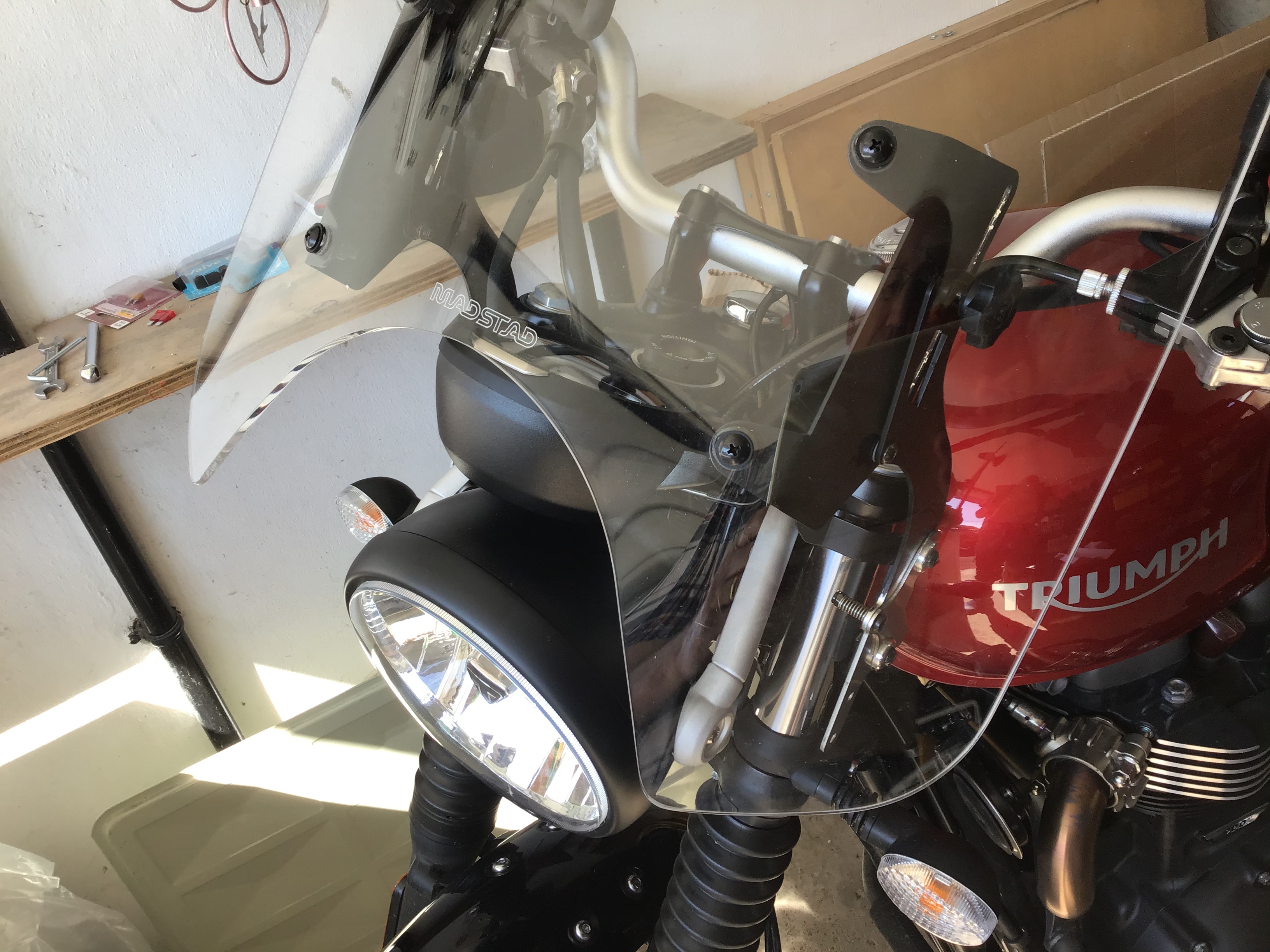

    So to my amateurish and non technical eye it doesn't seem to be a good fit. Surely the rounded bottom of the screen is designed that way to go around the headlight but in your photos it appears to be sitting way too high and there is a massive gap between the headlight and the bottom of the screen :neutral::neutral:
    Don't think it would make it look any nicer but the wind noise might be eased with a better fit ;);)

    Hmm, ... thanks yes you are right about the fit round the headlight and when I’ve looked at the photos on the Madstad website it is a close fit. I’ll have another go with the adjustment and see what happens... fingers crossed !:)

    Ah well ... no better with the screen at it’s lowest height to fit more snugly above the headlamp... this created head buffeting... prob by restricting the air under the screen it creates the imbalance with greater airflow going over the top. I then rode around and kept stopping to adjust it to each combination of heights & angles ... tried lowest height with each notch of angle and worked upwards...but still ended up with it at max height & max angle as a poor best. I’ve taken it off now and will likely only use it for longer faster trips. In the meantime I’ll e mail Madstad to see if they have any suggestions... thanks Helmut Visor for getting me to double check the fit. :cool:
