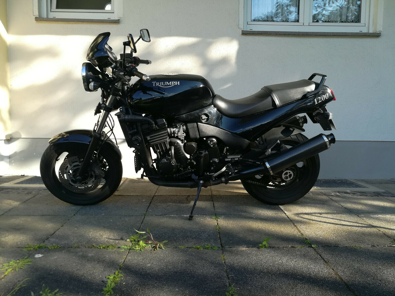

    Well my title is not entirely true to the story. So....a couple weeks ago I purchased a high mileage Daytona 1200 that had gone through a dubious second owner and a neglectful 3rd owner , who I purchased from. Bike was wrecked in the front and lost its fiberglass, owner #2 repaired and turned into a Speed four of sorts (see picture) it has 60k miles but the condition swayed me. Plus it was diiiirt cheap (now we know why maybe) . Owner #3 who I talked to quite a lot is a 20ish young man who purchased this as his first bike ever (insert joke here) and he rode it just enough to terrify himself. The bike sat in his Grandmothers Garage (I can confirm this because when I picked it up, the Granny was so happy to get her Garage back) while he started it once in a while and never really warmed it up as he is just a Kid and doesn't really know about heat cycles.
    Yes Caveat Emptor, I got the old girl home and fresh fuel. fresh battery.......no start. It did however cough a couple times and give the impression of about to start. I figured ethanol and over a year of sitting meant carbs. Took them off (OMG what a terrible job...never to be repeated if possible) and cleaned them, they were actually quite clean and gum / Crud free. I reattached said carb bank and attempted start...nothing...not a sputter. I pulled a plug, it was nasty, pulled another,,identical. Checked for spark and no little blue lighting strikes at all.
    Then for some reason I touched a plug while cranking.....ok there is spark that I could feel if not see. I tried the ground and crank again only to see arc from the plug to the frame but no electrode spark at all. I have included a couple pics of the plugs for your viewing pleasure. Can the plugs be so bad that they are out of action or is this a weak spark coil situation? The plugs in it are NGK R DPR8EA 9. With the exception of the electrode they look new, not several years old, but in truth the young man had only put on a documented 230 kilometers in 2 years.
