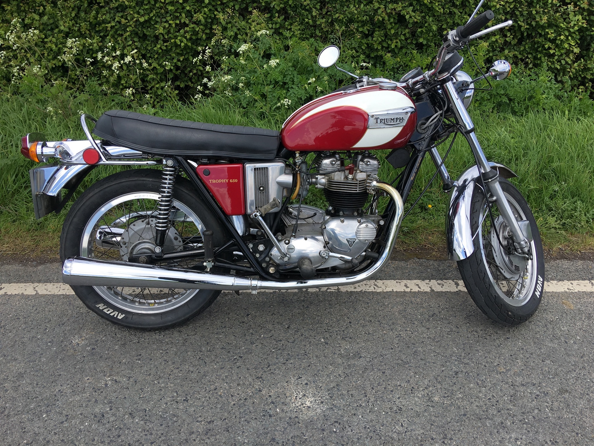

    does anyone know anything about triumph and the police force my barrel has a p stamped on it someone said its x police bik e. 1973 triumph trophy oif job

    Have a look at www.tri-corengland.com for the engine number dating system. I'm guessing that the P to which you refer relates to the month of manufacture (November) and not the year (1977).
    Then again I could have misunderstood your dilemma (nowt new there then)!
  3. darkman
    7,634
    Engine numbers are on the crankcase on the left hand side a P on the barrel has no real meaning. If its an ex Police bike the numbers on the crankcase will start with TR6P
  4. neil briscoe
    neil briscoe Member
    Apr 23, 2017
    S wales
    Yes mate that's what it has TR6P

    Only 25 made for the 73 year :) [​IMG]

    Thank you mate Looks like iv got one of them
  8. darkman
    7,634
    Any plans yet as to which way you are going with it.

    Did the police spec bikes, at one time or another, get some form of rubber mounting for the engine? I'm sure I read it somewhere.:confused:

    It doesn't look anything like that now

    A few bikes were made with rubber mounts just for evaluation but there is very little info on these bikes.

    So did a little birdie tell me you are thinking about some new wheels ?

    Yes mate I want the right size front wheel so that the front mudguard looks right and I have already got a nice rear wheel ready to fit just needs a tyre any suggestions oh and two new tyre clamps. Where can I get them from. Thanks again

    Don't mean to sound daft but what's the difference k70/81

    It's ok iv googled it. Thanks
  19. darkman
    7,634
    Either tyre would be ok for your bike, i use the K70's on my 69 T120 as they do a 400 18 rear and 325 19 front that were standard fit. As i ride my older bikes at a lot slower pace than my modern bike i find them more than adequate :)
