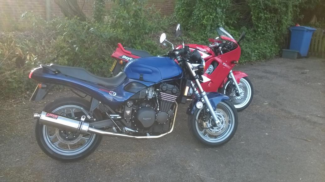

    Gus I have got a fully stainless set of 3 into 1 Motad pipes for a Trident 750 in my garage somewhere, they sound brilliant BUT.... You have to remove the centre stand as the exhaust on the other side has the stopper it so it doesn't hit the chain and also every time you need to adjust the chain or remove the rear wheel you need to take the rear exhaust off to get to it.
    Don't get me wrong it makes the bike sound great but there are a few disadvantages to having them as well.
    Here is a photo of it on the bike.
    Cheers
