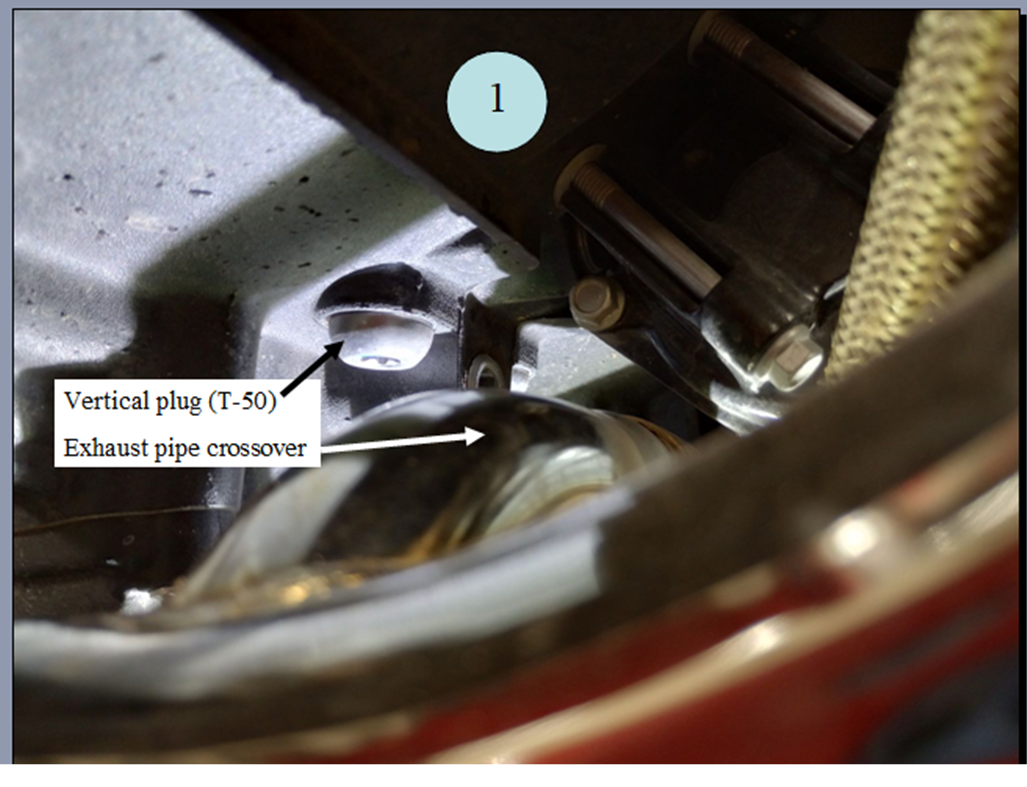

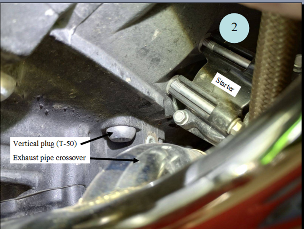

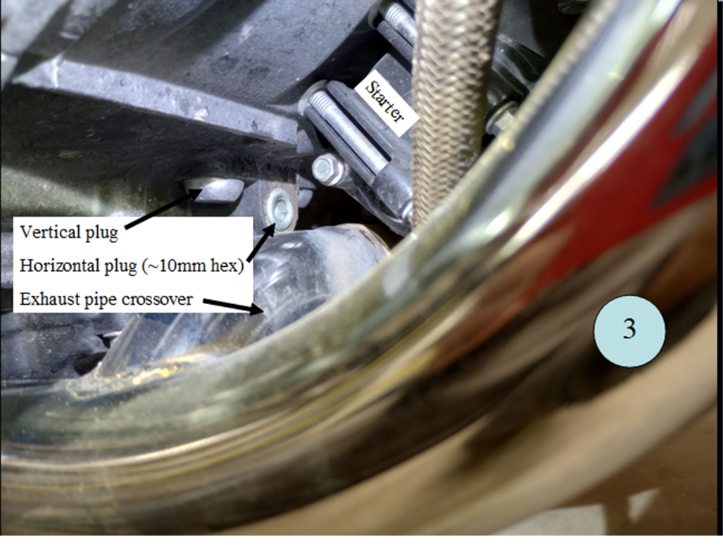

    There are 2 mystery plugs and I'd like to know if anyone knows what they are for, and if anyone has ever removed one of them - especially the vertical plug on the bottom (Torx T-50). Unfortunately, these aren't described or even mentioned in the Service Manual.
    My 3 pictures show the plugs in question. To remove the horizontal one (10mm hex), you'd have to remove both exhaust pipes to get access to the plug head.
    Any clues are appreciated. :)

    @MoreCowbell They are nothing to worry about. Stop worrying and enjoy the bike.

    They could be "drillings" to allow internal manufacture like for example oilways, from the outside. Certain machining processes may have to be done from the outside but, as in my example above of an oilway, you don't want the oil externally so it is capped.
    Why do you want to mess with them as it could turn into a can of worms?
    I'd leave well alone until such time as a full engine strip is required, THEN remove them to allow full casting cleaning ;)

    Can I ask why do you want to know?
    Are they causing a problem.
    From your picture...they are so close in I cant id the area they are.
