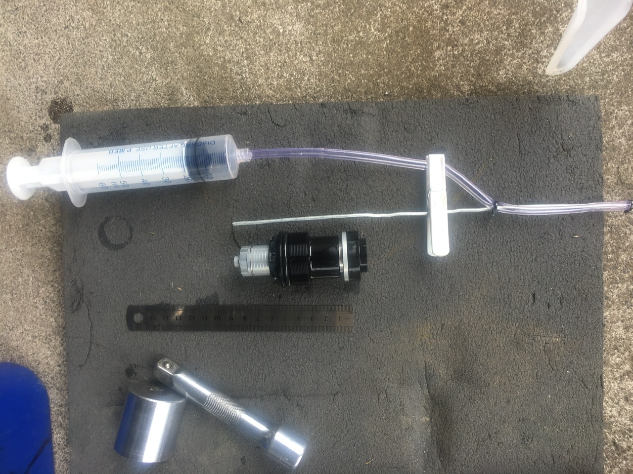

Oil measure and valve head
You can use a small ruler and a jug to measure the correct oil level (120mm setup for me), but a...

You can use a small ruler and a jug to measure the correct oil level (120mm setup for me), but a syringe attached to a measured length of hose makes it a simpler job.
